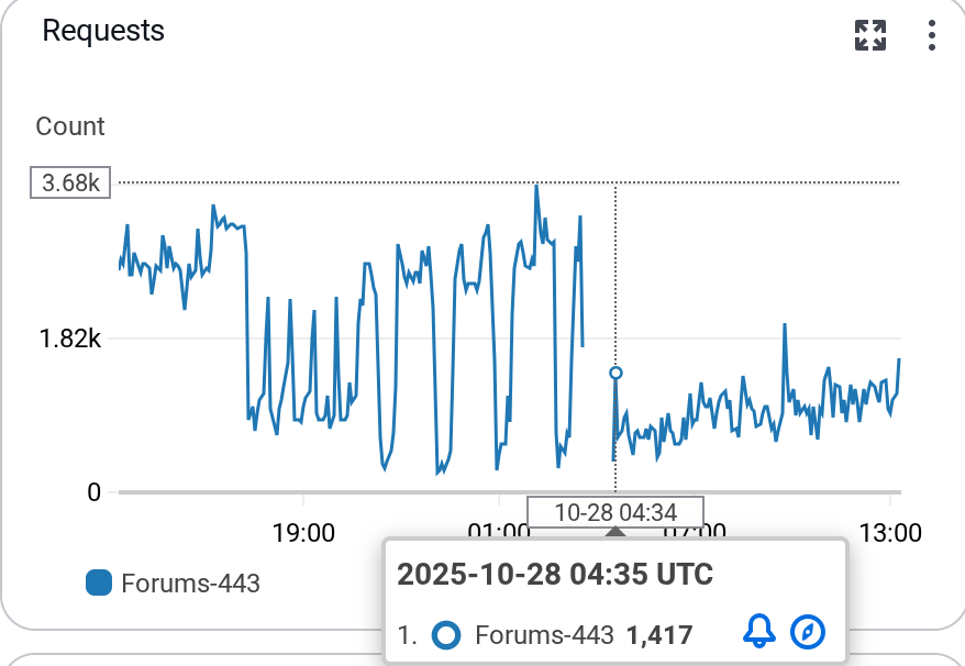

    We too initially thought the major AWS issue had affected the forums since it happened at the same time, but that was reportedly only for an AWS region we don't use. What has affected the forums was transient and mysterious, all year, and was progressively getting worse. There was a legacy mis-configuration that we found and fixed back in June I think, and things were better until recently. (Got something connected to the Internet? It WILL BE attacked- sometimes relentlessly)
    I now found that the incoming traffic followed an unnatural pattern - bursts of activity at regular intervals that would occasionally change in period; looks a bit like a square wave / pulse train when viewed at the right zoom level. Check out the most recent traffic request pattern leading up the vertical line at about 9:30 pm last night.
    This is somewhat typical of search engine bots, so I looked past it at first, but then noticed I could only get the forum running successfully again if I just happened to restart it during the low points (and it'd run for hours sometimes, and more recently only minutes), and eventually never again at all (most of yesterday).
    Cool pattern, huh? The gap after that pattern, and before 9:30-ish is where I'd completely shut off all traffic while I addressed the offenders and then opened it back up.
    The conclusion here (I hope) is that I found there was an abusive system, or systems, making ridiculous requests of our forum server that eventually caused it to spin its wheels. I found the abuse and put a stop to it.
    Now hopefully we can all get our forum "fix" again. :)
