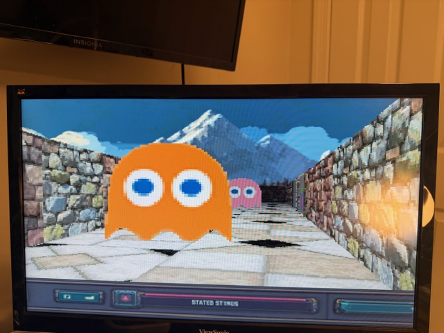

    Started implemented sprites.
    Now have one, single pixel wide sprite going.
    Seems if make sprites 64-pixels tall, then can reuse the wall drawing subroutine to draw the sprites.
    This is a huge speed benefit.
    Now implementing sprite calculations in another cog (still one left for audio).
    QVector instruction turns out to be very useful there:

    edited 2025-11-03 20:49
    Think have sprites working now...
    For sorting, trying a 1 pass bubble sort.
    Thinking that might be enough as the order shouldn't change much from frame to frame.
    But, the sprite cog has a lot of unused time where a multi-pass sort could go...

  • RaymanRayman Posts: 15,894
    So, the sprites are 64x64 pixels, just like the walls and floors.
    But, seems like inefficient to draw all the columns when many of them could be all transparent...
    Especially for human aspect ratio things and columns.
    Think should make a list of empty columns for every sprite. Maybe just a vertical sum...

    Was just checking how behaves with a lot of sprites...
    The wide open map is OK with a large amount of sprites with 16-bit PSRAM.
    But, chokes with 4-bit PSRAM.
    4-bit does work with the regular map that isn't so wide open though.
    So, there's a balance to think about...
    640 x 480 - 186K
