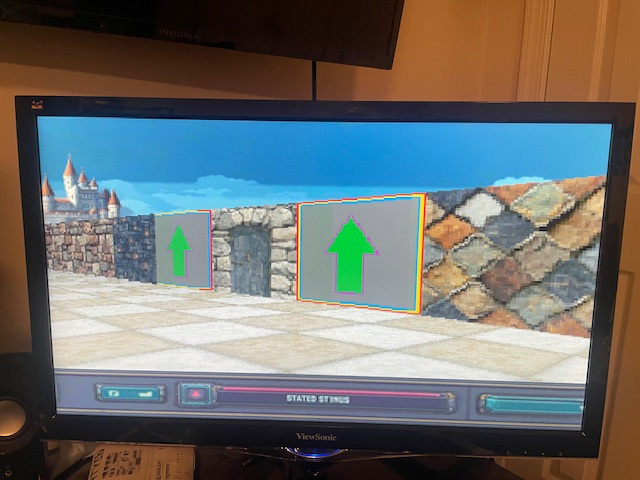

  • RaymanRayman Posts: 15,748
    Using Midjourney to generate new graphics. It's going to be a process to get it to do something useful.
    Think it's getting there though.
    Having but buffers in HUB takes up most of HUB RAM. But, there's still 90 kB left.
    Want to add variety of floor and wall tiles next.
    Wall and floor tiles are 8 kB each. So, maybe don't need to dynamically load those to hub right away...
    Implemented darkening of further away walls and floors.
    Used the simplest method, but may look into the other ways from here:
    https://forums.parallax.com/discussion/174921/
    This works, but max. frame rate drops from 100 to 90... Still good.
    Found some floor tiles to play with here:
    https://opengameart.org/content/200-tile-floor-textures
    Added a static status bar as an image in PSRAM that gets copied to buffer every frame.
    In future, this can be written on top of to show useful things...
    Max. frame rate dropped from 90 to 85 fps, still good.

    Now able to have multiple wall tiles. Tried to have them in PSRAM, but don't have that working yet.
    So, putting in hub for now...
    Also updated the map to be easier to visualize:
