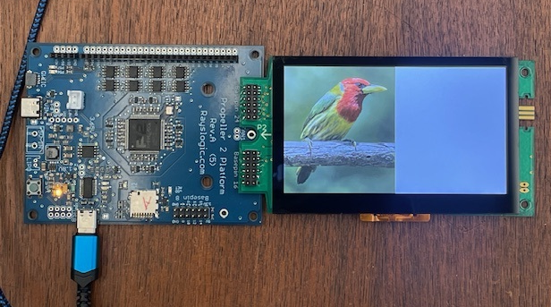

Just got to work testing some prototype TFT LCD adapters for two header Platform/Eval/Edge type setups.
A very long time ago did something like this in 24 bpp with 480x272 resolution, using two octal buffer to help hold the data from 8-bit bus.
That was fine, but now there are 800x480 resolutions version of the 4.3" and 5.0" IPS TFT displays.
P2 isn't fast enough to do 24 bpp on these.
So, new version is 16bpp with just one octal buffer chip. This should let us do 800x480, if math was done right...
Thinking this will work great with the 16bpp PSRAM GUI also being worked on...
Idea was for this to work on the new Platform board, but also the Eval and Edge.
Now that have it though, it's pretty clear that the header side interferes with stuff on Eval and Edge.
Have to remember to fix that in next version...

    Practicality of the 800x480 driver/display is questionable without PSRAM.
    This test image takes up most of hub ram and only covers half the screen.
    Could working in 8bpp and have another cog convert from 8bpp to 16bpp by scanline though.
    https://en.wikipedia.org/wiki/Blue_jay#/media/File:Cyanocitta_cristata_cyanotephra,_Lubbock,_Texas_2.jpg
    Hard to get a good photo of screen with iPhone... Screenshot below shows some hashing that isn't really there...

    Picking this project back up. New board is working with 800x480 IPS LCD (WVGA).
    This one only has one buffer chip, so is rigged for 16bpp.
    Think going to focus on 16bpp mode and working with the PSRAM drivers...
    Could also do 8bpp with LUT, but skipping that for now.
    There's not enough hub ram for a full 800x480 16bpp image, so just doing half the screen here.
