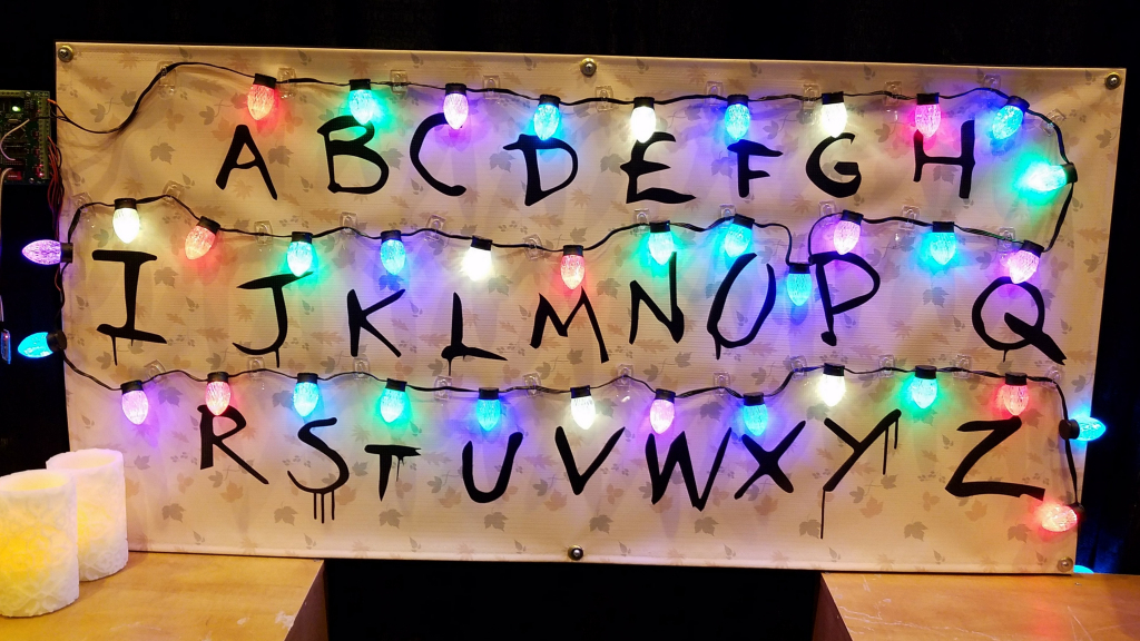

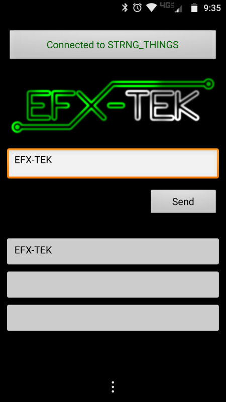

  • I've used the HC-0x modules as receivers on P1s many times, usually controlled through a terminal app on my phone. The attached picture shows a mini "Stranger Things" wall I made with WS2811 Christmas lights. I made a little BT app for my Android phone using MIT App Inventor that allowed me to control the lights with a P1. Mostly I'd ask a customer who was visiting the booth their name, type it in, and the P1 would spell out their name on the lights. It was a big hit.
    From a code standpoint, it was just a serial connection on the P1 side.

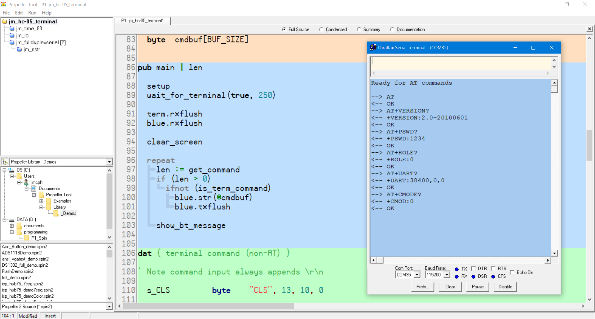

    I went through old parts boxes and found an HC-05 and cleaned up the attached terminal program which can be used to set-up your HC-05s. The only drag is that you have to push a button on them while applying power to get them into command mode.
