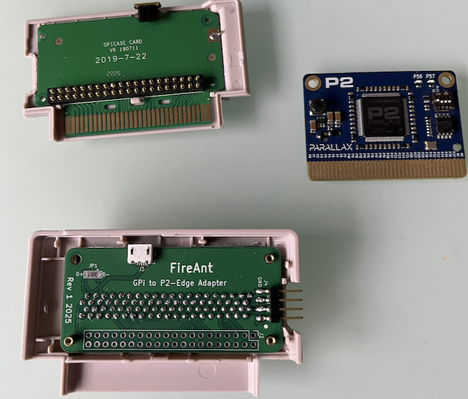

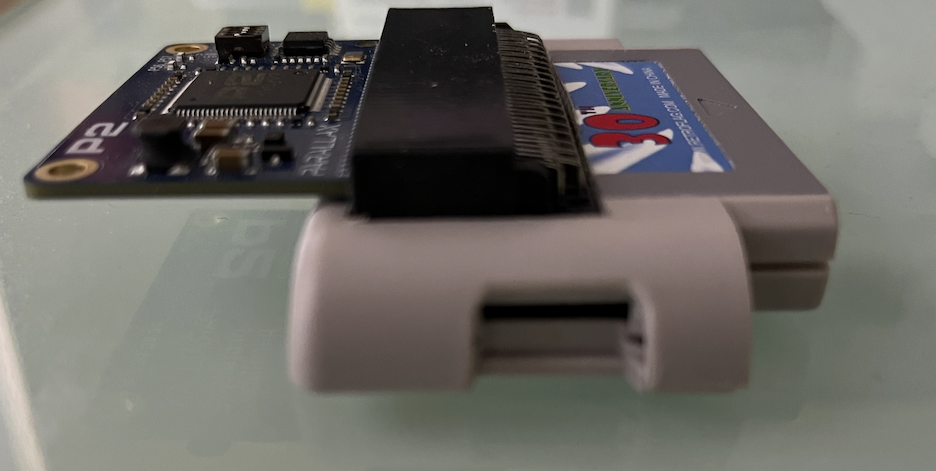

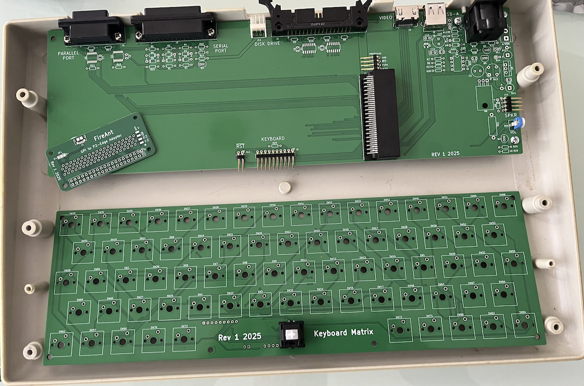

  • Boards arrived yesterday after a little bit of a delay from other things happening. I'll try soldering the FireAnt PCB sometime this weekend and start testing the audio and video interfaces and check the USB path still works to the GPi Case 2W handheld system.
    The larger board(s) are for my future Microbee emulator "P2BEE2" which also uses a P2-Edge (original, non PSRAM version). They fit in the case nicely.
    I realized later that I omitted any series resistors for the USB D+/D- lines in these designs. Hopefully that's not going to be an issue for host side use. I don't believe the Parallax P2 (host) accessory board uses them either, only the device side has them so I think I'm okay.

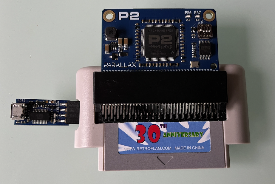

  • Solder paste is out of the fridge now warming up. In the meantime I did some Dremel & filing work on the cartridge backshell and was able to fit the FireAnt board into the enclosure with the Edge connector sticking out the back. Just had to remove one metal insert boss on the top corner. Should still close up and provide sufficient pressure on the pogo pins for a decent contact.
  • roglohrogloh Posts: 6,233
    edited 2025-09-13 06:35
    Soldering done and it all seems to fit in quite nicely. The Micro USB connector was a bit of a PITA as I had a nasty solder bridge tucked in under the legs to sort out. The PropPlug is nicely accessible through the normal RasPi uSD opening. In theory you could just use this as is if you only wanted 32MB of RAM. It's not a bad solution even though it was just planned for an initial test setup, but a fully custom board inside the cartridge is nicer. Will start testing soon, probably tomorrow.
  • Now if only it works...
    edited 2025-09-13 11:10

    I know. Maybe by tomorrow we will find out with any luck. I can try running my updated video driver with parallel LCD support and tweak timings, and figure out some PWM pin settings for playback of an audio waveform (and also try line level out with the DAC in case that also works).

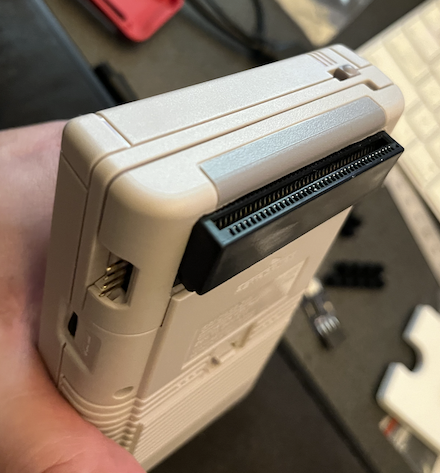

  • Getting a response from P2 in GPi. Then hacked up a simple static pin output test with 19.2MHz pixel timing with CLK&DE driven but without VSYNC, HSYNC activated, using a RasPi modeline I found online for the GPi case 2W:
    hdmi_timings=640 0 1 1 20 480 0 1 1 2 0 0 0 60 0 19200000 1
    Tried both DE pin phases with RED/BLUE MSB data pins activated and also scoped the pins on a seperate P2-EVAL to ensure this code was working but nothing is being displayed on screen as yet.
    Tried with HSYNC/VSYNC floating, as well as driven statically high or low in case that mattered.
    So I probably have either :
    1) unsupported pixel timing
    2) or it really wants the HSYNC and VSYNC (I was sort of hoping it might not need them to make things a little easier- some LCDs get by without these signals)
    3) something else...
    I am assuming 2) for now and now need to either write more special test code, or dig up and port some old LCD code I had somewhere for my video driver and test it more fully.
    I may also have to separately probe a RasPi out of its cartridge with my logic analyzer to see what exact timing it is using. I know it does generate the VSYNC and HSYNC signals by looking at its configuration, so it's probably just that.

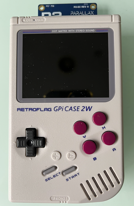

    Yes, just added VSYNC and HSYNC pin toggling to this test code and am seeing a coloured image now with this timing above. :smile:
    Update: Looks like it works at 250MHz with the same timing above. Also it seems to work without the DE signal too :smile:
    Tried SNECOG but no sound is coming out yet even though video screen is active (I also drove that power enable pin in case that turns on the amp). I wonder if it needs a logic level signal if it's buffered and not a DAC output. Will try some NCO frequency outputs to try to make a noise...
    Update: No luck with audio so far and I'm hearing nothing regardless of how I drive the PWM audio pins with NCO DUTY mode, or PWM triangle or manual bit banging etc, despite seeing lots of pin transitions on a scope. I wonder if we need to activate the USB port first to enable the amp - in case that's used to suppress initial clicks/pops at startup or something. Or possibly the audio frequency needs to remain in some limited range to work - I should go probe the RasPi output to see what that does I guess.
