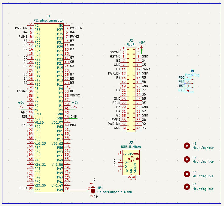

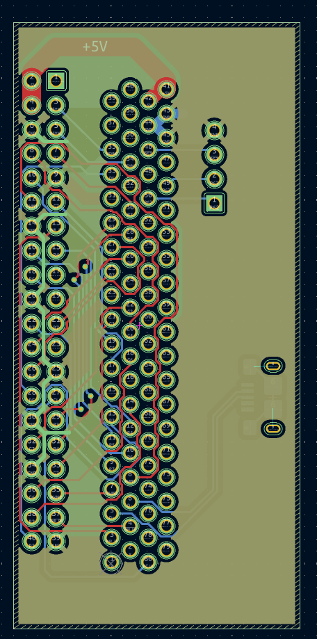

    Here's the rough idea of what I am intending to do for testing (from KiCad). Forget the 2x20 pin header in the 3d render, that's just where the pogo pins would connect. Just need to figure out the P2 pin assignments for the layout.
    @Wuerfel_21 do you have any input here as to what best to do for DE/VSYNC/HSYNC/PCLK signals and your drivers so it has the best chance of working first go? I'm only intending to use the P2-Edge EC32MB signals from P0-P39. Should we associate pins 0-23 for RGB or pins 8-31 for RGB leaving some lower accessible ones in the P0-7 range for DE & SYNCs etc? I guess I can just put USB and audio somewhere and the power on/off signals up on P32-P39 to make room. No need for any spare HDMI output pins for now during testing. Not sure where the PCLK should be located, probably also in the P32-P39 range to keep it from messing up the streamed video. Can't recall if streaming video overrides smartpins controlled from the same COG, I know it's one or the other and there were restrictions there. Also were there any issues with P2EC32MB and any fast transitioning signals on P28-P31 with PLL jitter or was that board revision fixed??? I wonder if the red video signals would mess anything up there.
    EDIT: wiring looks a bit nasty assuming P8-P31 for RGB use (in fact it's P10-P15, P18-P23, P26-P31 for BGR). Might have to go 4 layers.
    Turns out 2 layers can route all the signals, but the ground connections got trashed and isolated so I'll just have to go to 4 layers (although we probably don't need to connect to all of them). It will help signal integrity anyway too.
  • Ostensibly 8-31 is better, but I think the signals wrap around within the port (TODO confirm?), so you can do 0-23, too.
    Assuming 8-31 for BGR, the HSYNC/VSYNC/DE should go either on 0-2 or 5-7. Clock should probably also be around there, but doesn't really matter since that's its own smartpin. Putting other stuff on the 8 pins that correspond to streamer channel 0 shouldn't be an issue, since they never go high unless asked to. The other stuff I'll need to check.
    P2EDGE uses an active oscillator, so shouldn't have the PLL issue. The signal will only switch at ~13 MHz anyways, not so high-speed at all.
    Audio probably should go on the other port, just to be away from all the 60Hz waveforms.
  • roglohrogloh Posts: 6,095
    edited 2025-08-22 13:23
    Ok, thanks. For now I've placed V/H/DE on 5-7 and kept the BGR video on 8-31 (with 2 LSB gaps per colour). All the other non-video stuff is already up at P32-P39 along with the pixel clock which I think can be located up there too (as it's closer to run to the final RasPi header pin and away from interfering with most of the other signals). I added the other inner layers as ground planes and routed in the extra ground pins that were isolated before, so it's essentially done now electrically. If you can, let me know asap if you do think of any issues otherwise this schematic might be the final mapping. Just need to tidy up final board cut dimensions and drill hole mounting positions now before ready to send it off.
  • Video stuff LGTM.
    Not sure what's going on with the USB? Shouldn't that also go to the connector? (and host-side should really not be on a micro-B) Also not entirely sure how the driver copes with not having power management (i.e. if you reset the P2 does the driver manage to pick off from the already-initialized state?)
    Also, just remembered another software limitation in my code, pin 0 (DIGITAL_BASEPIN in this scenario) gets blasted with WXPINs due to the HDMI audio implementation. Currently not hooked to anything, but maybe smarter to move H/V/DE down? That's just a software meme though, can be fixed if push comes to shove.
    edited 2025-08-22 14:42
    @Wuerfel_21 said:
    Video stuff LGTM.
    From what I imagine is that the USB port would be acting as host via OTG on the RasPi Zero's micro-AB port and the RPi would poll the USB controller. I don't think they have special software on the Pi acting as a device client that gets pushed the button state, instead the Pi just polls the USB device. Now as far as the attachment stage goes, it's sort of always connected from bootup internally so hopefully the state machine in usbnew can cope with that and doesn't need to wait for an explicit connection. But perhaps the micro on board the RPi Case 2W does something fancy and triggers a bus attachment somehow - this is a bit of an unknown however. For now I want to assume it's going to be able to work one way or another and won't be a show stopper.... famous last words I guess.
    What is the actual reason for considering moving H/V/DE down from 5,6,7 ? Where is the DIGITAL_BASEPIN again in your code - it's on the HDMI base pin right? If it can be nominated as anything I do have a spare pin separate to the streamer stuff up at P39 if that helps? Other free pins are at 0,1,2,3,4,8,9,16,17,24,25.
    It should at the very least work on a cold boot. I think someone somewhere had a board without USB power control, I remember specifically adding the option to not have that pin. But IDK if that worked well or caused problems.
    If there's no digital audio out, there's no pin needed, it's just easier to make the sound cog always write to a digital basepin if it exists in the config at all (not -1). So if the basepin isn't actually used by the LCD format, whatever else ends up there gets blasted with audio samples just because it's harder to not do that. So it's better to use the base pin for something harmless like HSYNC (which would never be in a smart mode that cares about the X register). But again, that doesn't break for your current proto that doesn't have P0 on anything at all

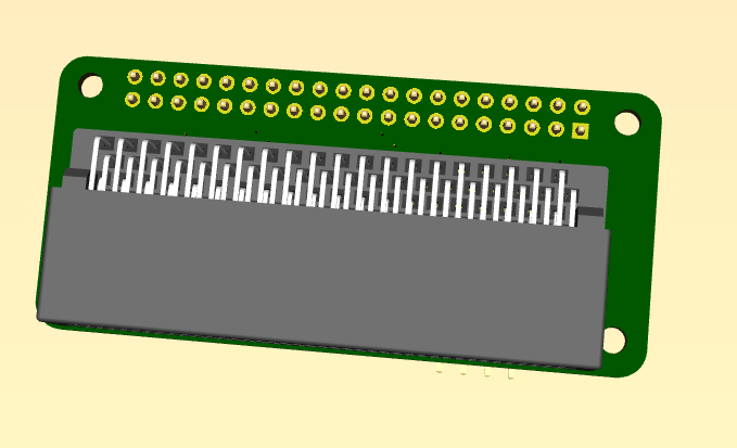

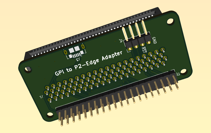

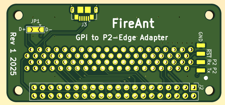

    I'm very close now. I'll post the KiCad files and Mouser BOM as well soon if others also want to make one up at some point. One other thing is I'll probably bring the PropPlug out the uSD card opening for easy attachment. The 4 pin PropPlug header should fit nicely through that existing cut out in the cartridge. Just need to make an SMD footprint and find a right angle pin header and adjust the layout slightly.
    I've made this adapter board which I'm now codenaming the little FireAnt the same size as a RasPi Zero and from a mounting point of view I think the Pogo pins are going to need pressure applied to work right so the cartridge's plastic backshell really still needs to be affixed. I think I can keep three of the four internal tiny (~1mm ID threaded and 2.5mm OD) metal mounting bosses that get screwed into, but the fourth one may need to be hacked out with some blade work to make room for the larger P2-Edge connector to pass by - it's just a tad too wide to fit without removal unfortunately. However it should still be sturdy enough after that I would expect and if not that little metal boss could be moved slightly and glued in a different place if required. The P2-Edge PCB will then slide in behind the cartridge through the partially exposed edge connector at the back.
    BOM UPDATE: (Qty, Mouser part #, Description)
    1,640-USB3076-30-A, USB Micro-B connector
    1,619-450-00308, Parallax 80 pin Edge connector R/A
    1, 855-M20-8900405, 4 pin 0.1 inch SMD header R/A
    edited 2025-08-23 06:11

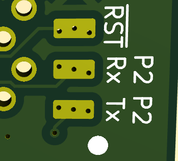

    Ok we are done. This should be final now I expect and dimensions should be good. Gerbers attached in zip file for anyone else keen to try this as well as me (4 layer PCB). The BOM was already shown above (only 3 items are needed for this simple board). A solder jumper has been added to optionally connect P2 IO pin 39 to either USB D+ or D- signals for a simulated pullup resistor to (re)trigger USB device attachment at startup etc (or we can leave it unsoldered if having this ends up being useless or harmful). It is a spare pin otherwise.
    EDIT: I just added in pad vias on the Prop Plug pads to try to stiffen them against ripping out with the SMD header pins flexing. This is in the separate zipfile called gpi2w-vias.zip (in case your fab house can't put vias in pads you can use the original).
    EDIT2: hold the phone, the Raspi connector position got shifted and PCB needs a fixup tweak. Will repost fixed gerbers when this is done. EDIT3: Ok fixed now. Gerbers should be good again.

    Busy yeah, and it's good practice learning KiCad right now. I've emailed you some of these files too if boards are going out soon. The case I found should be great if it all works out, still a small gamble on the USB controller side, though I expect the LCD + audio stuff will probably be usable. We'll see soon enough once this FireAnt PCB comes back.
