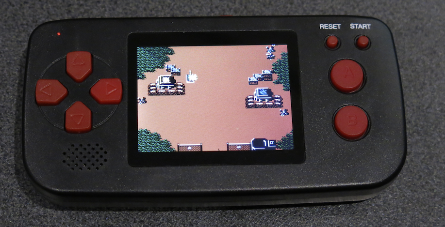

  • RaymanRayman Posts: 15,949
    It’s the 2.3” modules from buydisplay.com
    They have a special driver that allows landscape scan in rgb mode. So it’s basically a digital version of vga.
    Seems the other displays are either portrait or don’t have rgb mode.
    Wish it were bigger but this seems fine with intended audience.

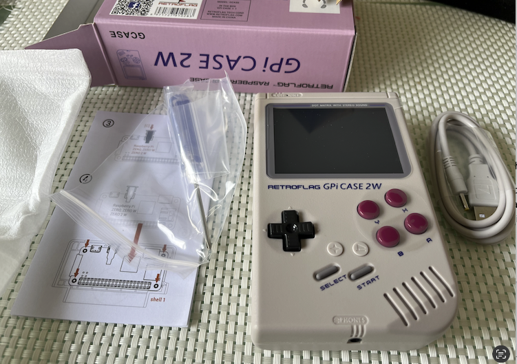

    I think this handheld case could be promising for a P2 handheld console device hack (at least vs what I posted above). On a custom P2 PCB using the standard Raspi Zero form factor we could feed parallel RGB video, PWM audio and USB for the button controller out the same GPIO pin positions the Raspi Zero 2W uses and to a single micro-usb connector attached to the existing flat flex cable provided. Pogo pin connections to the enclosing cartridge's IO conversion board adapting to an edge connector into the main screen board make it simple to swap over from a Raspi and you'd still have external access to a microSD for files. There is another more advanced version of this case that even offers a dock with HDMI which could also work as a basis for a console but the CM4 interface is more complex to design for. This 2W case version uses a larger 3 inch landscape 640x480 IPS screen which potentially works nicer with Ada's emulators and other applications that need higher resolution than 320x240. I might get one to try out.
    https://core-electronics.com.au/retroflag-gpi-2w-handheld-console.html
    EDIT: actually once you know the edge connector pinout used by the cartridge you could probably simplify things and bypass the whole pogo pin route and redo the adapter board inside the cartridge to hold the P2 itself, plus that gives you a bit more space to lay it out. Just wire in Parallel RGB, PWM audio, USB, power and the microSD card for a filesystem. You'd still have enough leftover pins on a P2 to add quite a bit of 16 bit wide PSRAM too (64MB or maybe 96MB).
  • roglohrogloh Posts: 6,215
    edited 2025-08-21 04:25
    So I just bit the bullet and ordered one of these GPi Case 2W handhelds plus an additional empty cartridge that I can mod with a P2. Initially might even just make up an adapter board with the P2-Edge connector and simply slide in a P2-Edge EC32MB externally for the fastest solution.

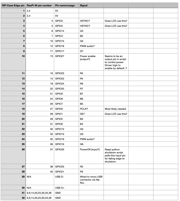

    From what I've been able to ascertain, this device seems to use a 32 pin card edge connector with the following signals present (normally from the Raspi GPIO):
    • 18 bits of parallel RGB video (DPI 6:6:6 mode)
    • CLK, DE, HSYNC, VSYNC signals - which of this set is required by the LCD not sure yet.
    • 2 PWM channels for audio, integrated speaker might be mono and need mixing?
    • a poweron input signal and a poweroff output if safe shutdown is enabled, but these can be ignored if safe shutdown is disabled (via a slide switch on the main unit)
    • 5V supply input
    • USB D+/D- for connection to integrated XBOX360 like USB controller reporting button state
    The screen is powered via the internal Lipo battery and has an inbuilt amplifier and USB gamepad controller. There is likely a boost converter providing 5V to the Raspi.
    This is still a bit of a gamble as I don't know the range of frequencies the LCD supports, and whether or not usbnew will recognise the USB controller hardware (eg. if a USB2.0 or 1.1 HUB etc). Also whether or not any of Ada's emulators can be coaxed to output parallel RGB... :o Getting a clock signal out is usually okay if pixels are synchronous to the P2 clock, but a DE signal requires setting up a smartpin in PWM mode and doing some extra tweaks to it during vblank to zero it. I've done it with my own video driver SW but not sure about within Ada's code whether that's possible yet. Hopefully it is.
    But if all else fails with P2 integration on this device I can always use it with a RasPi Zero and Retropie etc, so all is not lost.
    Actually using the P2-Edge may also allow HDMI out as an extra/alternative option.
    P0-P23 - parallel RGB
    P24-P27 - CLK, DE, H, V
    P28-P29 USB D-/D+
    P30-P31 PWM audio
    P32-P39 HDMI
    I can probably also reuse the lower 2 bits of R/G/B as well for additional signals given the LCD edge connector only carries 6 bits per colour channel. That could allow a dedicated SD card to not interfere with on-board boot flash.

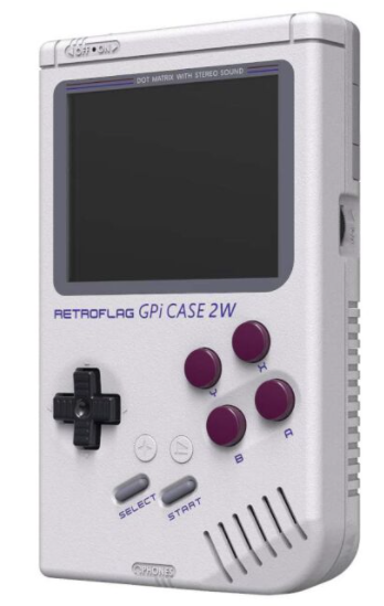

    3 inch 640x480 LCD.
    Here's a nice review.

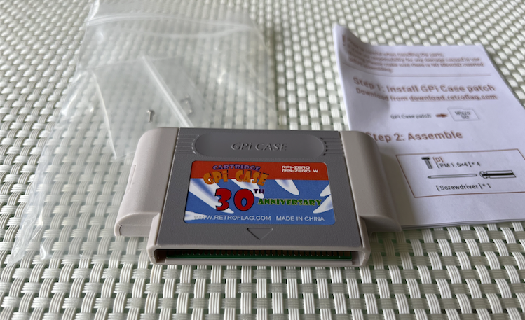

  • Well it just showed up, less than 24 hours post from Sydney to Melbourne, not bad. I'll post more details about the insides in a bit. Want to reverse engineer the pinout.

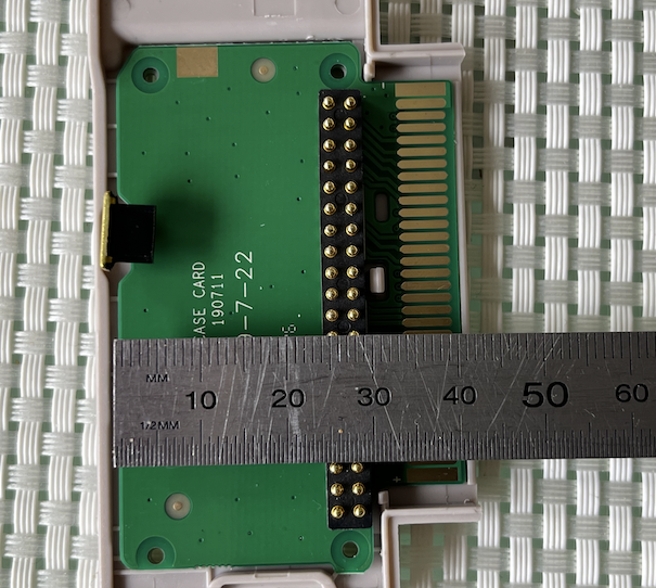

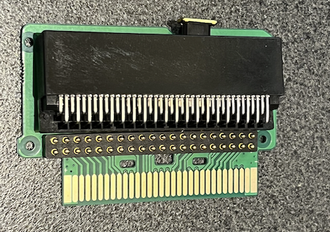

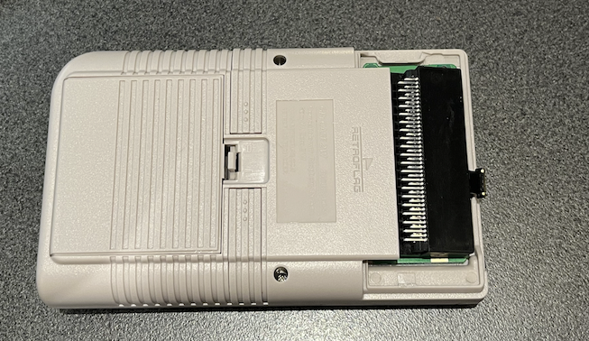

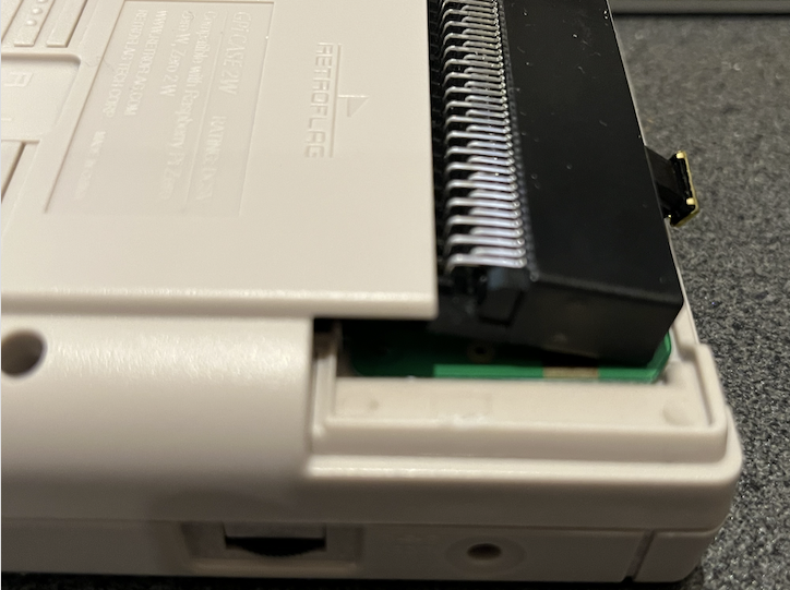

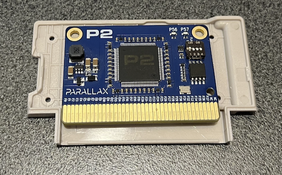

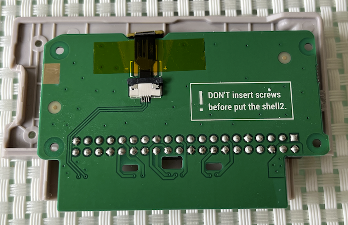

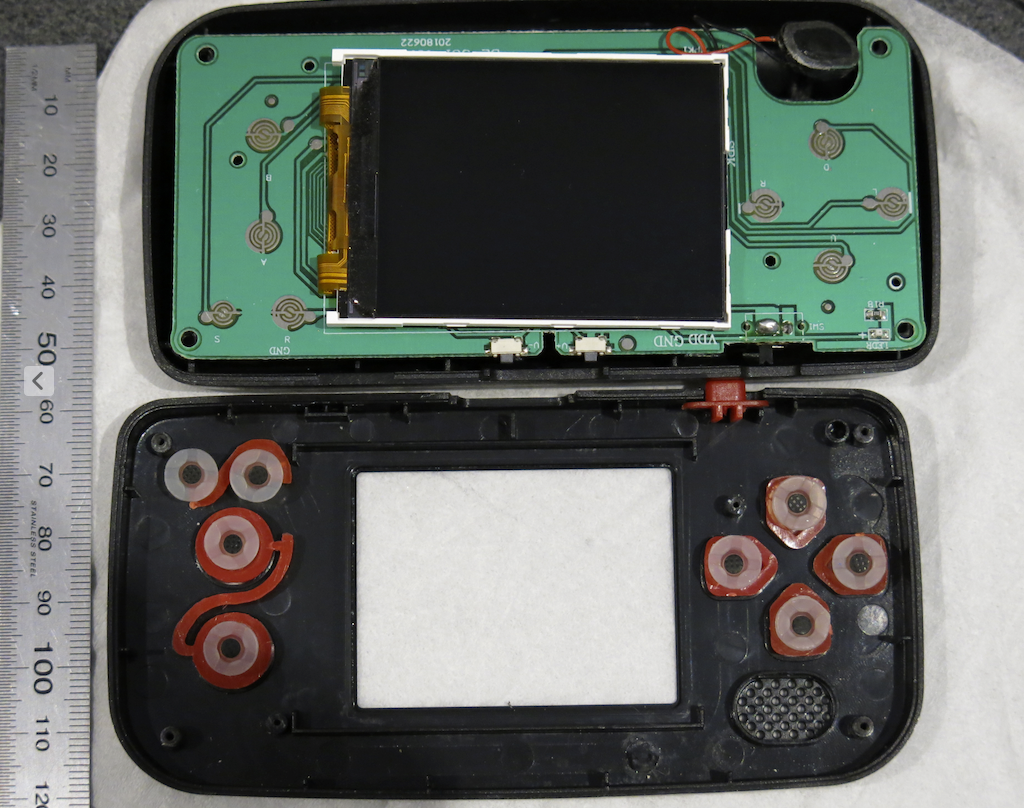

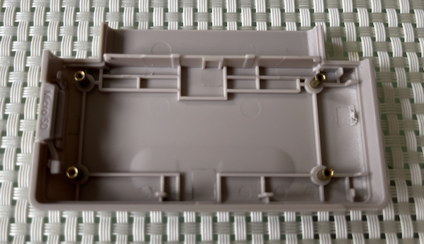

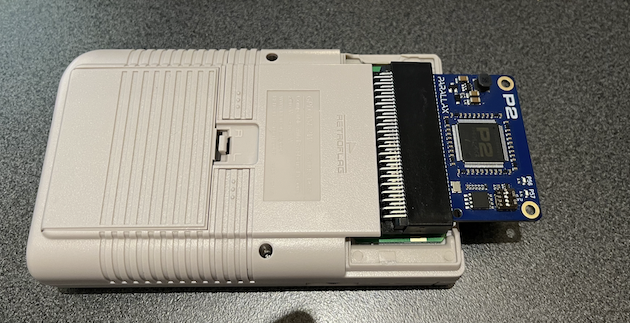

    Did some probing and measuring with calipers and took more pics. The PCB with the edge connector that connects to the Raspi using pogo pins is 41x63.5mm and 0.8mm thick. The narrower card edge part is 49.5mm wide and 11.3mm long with the edge fingers reaching back 7.5mm from the edge. Pin pitch seems to be 1.5mm.
    The height available from the surface of this board to the (deepest) plastic case parts underneath is 6mm and about 5mm where blocked by the pattern of stiffening regions.
    A P2 edge connector can fit onto the board. Height means it will protrude through the cartridge plastic which needs to be cut and is to be expected.
    A dedicated P2 board could potentially fit inside as shown by a P2-Edge's size relative to this case.
    I also buzzed out the connector (aligning pin1 with the leftmost edge of the board printed with a + symbol on the silkscreen). Here's the mapping I found:

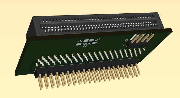

    Update: For initial testing I think I might make a board that has the 40 way Raspi header and the P2 Edge connector and uses the pogo pins to contact my board. I will have to wire in a separate micro usb socket to this board as well, but it's a simpler test board than getting the edge fingers fully right first go.
    I did just check without anything connected and the main power switch turned on that 5V was present between pins 1,2 and 31,32. So the Lipo boost converter is definitely active. Nothing was visible on the LCD screen, so I'm guessing the micro on the main board detects signals before powering it up and turning on the backlight etc. I was also reading somewhere that you can run it as an XBOX 360 style USB controller via its own dedicated micro USB port accessible under the battery cover that is also used for firmware upgrades. Will have to try that out at some point.
    edited 2025-08-22 07:24

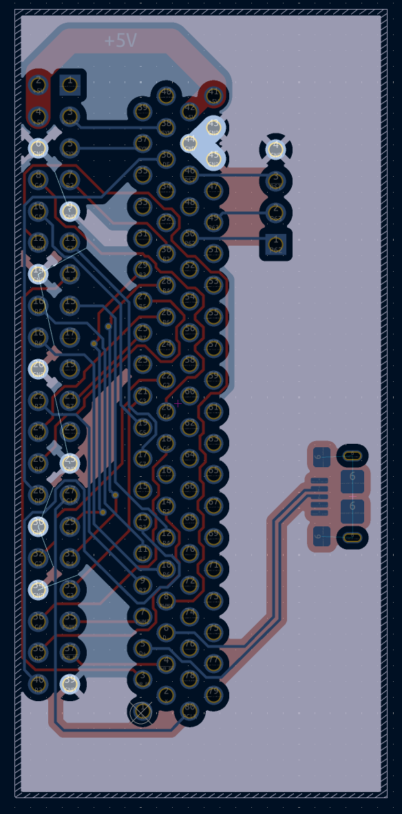

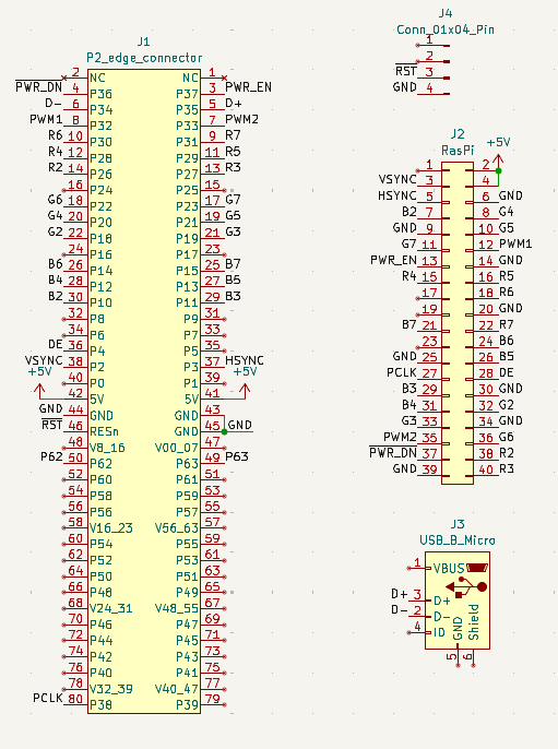

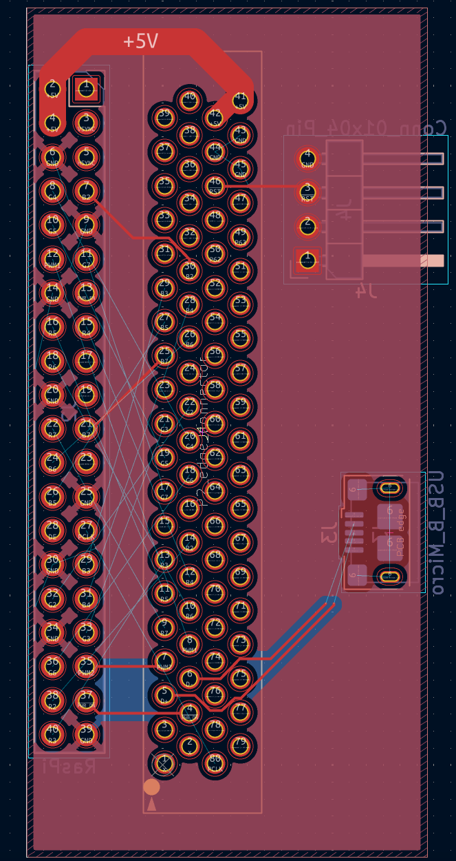

    Here's the rough idea of what I am intending to do for testing (from KiCad). Forget the 2x20 pin header in the 3d render, that's just where the pogo pins would connect. Just need to figure out the P2 pin assignments for the layout.
    @Wuerfel_21 do you have any input here as to what best to do for DE/VSYNC/HSYNC/PCLK signals and your drivers so it has the best chance of working first go? I'm only intending to use the P2-Edge EC32MB signals from P0-P39. Should we associate pins 0-23 for RGB or pins 8-31 for RGB leaving some lower accessible ones in the P0-7 range for DE & SYNCs etc? I guess I can just put USB and audio somewhere and the power on/off signals up on P32-P39 to make room. No need for any spare HDMI output pins for now during testing. Not sure where the PCLK should be located, probably also in the P32-P39 range to keep it from messing up the streamed video. Can't recall if streaming video overrides smartpins controlled from the same COG, I know it's one or the other and there were restrictions there. Also were there any issues with P2EC32MB and any fast transitioning signals on P28-P31 with PLL jitter or was that board revision fixed??? I wonder if the red video signals would mess anything up there.
    EDIT: wiring looks a bit nasty assuming P8-P31 for RGB use (in fact it's P10-P15, P18-P23, P26-P31 for BGR). Might have to go 4 layers.
    Turns out 2 layers can route all the signals, but the ground connections got trashed and isolated so I'll just have to go to 4 layers (although we probably don't need to connect to all of them). It will help signal integrity anyway too.
  • Ostensibly 8-31 is better, but I think the signals wrap around within the port (TODO confirm?), so you can do 0-23, too.
    Assuming 8-31 for BGR, the HSYNC/VSYNC/DE should go either on 0-2 or 5-7. Clock should probably also be around there, but doesn't really matter since that's its own smartpin. Putting other stuff on the 8 pins that correspond to streamer channel 0 shouldn't be an issue, since they never go high unless asked to. The other stuff I'll need to check.
    P2EDGE uses an active oscillator, so shouldn't have the PLL issue. The signal will only switch at ~13 MHz anyways, not so high-speed at all.
    Audio probably should go on the other port, just to be away from all the 60Hz waveforms.

    Ok, thanks. For now I've placed V/H/DE on 5-7 and kept the BGR video on 8-31 (with 2 LSB gaps per colour). All the other non-video stuff is already up at P32-P39 along with the pixel clock which I think can be located up there too (as it's closer to run to the final RasPi header pin and away from interfering with most of the other signals). I added the other inner layers as ground planes and routed in the extra ground pins that were isolated before, so it's essentially done now electrically. If you can, let me know asap if you do think of any issues otherwise this schematic might be the final mapping. Just need to tidy up final board cut dimensions and drill hole mounting positions now before ready to send it off.
  • Video stuff LGTM.
    Not sure what's going on with the USB? Shouldn't that also go to the connector? (and host-side should really not be on a micro-B) Also not entirely sure how the driver copes with not having power management (i.e. if you reset the P2 does the driver manage to pick off from the already-initialized state?)
    Also, just remembered another software limitation in my code, pin 0 (DIGITAL_BASEPIN in this scenario) gets blasted with WXPINs due to the HDMI audio implementation. Currently not hooked to anything, but maybe smarter to move H/V/DE down? That's just a software meme though, can be fixed if push comes to shove.

    I've made this adapter board which I'm now codenaming the little FireAnt the same size as a RasPi Zero and from a mounting point of view I think the Pogo pins are going to need pressure applied to work right so the cartridge's plastic backshell really still needs to be affixed. I think I can keep three of the four internal tiny (~1mm ID threaded and 2.5mm OD) metal mounting bosses that get screwed into, but the fourth one may need to be hacked out with some blade work to make room for the larger P2-Edge connector to pass by - it's just a tad too wide to fit without removal unfortunately. However it should still be sturdy enough after that I would expect and if not that little metal boss could be moved slightly and glued in a different place if required. The P2-Edge PCB will then slide in behind the cartridge through the partially exposed edge connector at the back.
    BOM UPDATE: (Qty, Mouser part #, Description)
    1,640-USB3076-30-A, USB Micro-B connector
    1,619-450-00308, Parallax 80 pin Edge connector R/A
    1, 855-M20-8900405, 4 pin 0.1 inch SMD header R/A
    edited 2025-08-23 06:11
    Ok we are done. This should be final now I expect and dimensions should be good. Gerbers attached in zip file for anyone else keen to try this as well as me (4 layer PCB). The BOM was already shown above (only 3 items are needed for this simple board). A solder jumper has been added to optionally connect P2 IO pin 39 to either USB D+ or D- signals for a simulated pullup resistor to (re)trigger USB device attachment at startup etc (or we can leave it unsoldered if having this ends up being useless or harmful). It is a spare pin otherwise.
    EDIT: I just added in pad vias on the Prop Plug pads to try to stiffen them against ripping out with the SMD header pins flexing. This is in the separate zipfile called gpi2w-vias.zip (in case your fab house can't put vias in pads you can use the original).
    EDIT2: hold the phone, the Raspi connector position got shifted and PCB needs a fixup tweak. Will repost fixed gerbers when this is done. EDIT3: Ok fixed now. Gerbers should be good again.

    It'd be good to try to test something in the meantime but the rear cover occludes the pogo pins for direct probing and some type of adapter board really needs to bring the signals out beyond that. If I can solder some wires onto some 0.1 inch matrix board to 6x2 headers I might be able to hook in a P2-EVAL for testing the video timing or USB controller perhaps in the meantime. The problem is any attached board needs pressure applied to make a proper contact to the pogo pins and will slip off easily without clamping it down. Although maybe I can solder something onto the gold edge fingers directly for USB signal tests. Trying not to trash the edge connector however. If I attach the microUSB flex to the Parallax Serial device breakout accessory and wire in a common ground wire to the gold square ground pad (this USB connector floats) it might be possible to test the USB but only if it works without the screen being active first....
  • Ah, I see, that's what's going on with the USB connector. They designed it to plug into the Pi Zero. Yeah that's just doing OTG, which should work passively if you're just trying to be a host. I think an actual OTG device needs that extra 5th pin to do something to switch into host mode, but we just assume we're a host (and I think the Pi Zero does, too? I don't think it can do device mode?) So trying it with the Serial Device accessory is fine if you can manage that.
    You're saying this USB connector doesn't have GND and VBUS connected to anything? That'd be odd.
