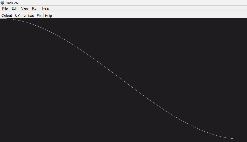

  • @"R Baggett" said:
    Brilliant indeed.. but not an 'S' curve. Thanks!
    What shape would you call it?
  • Oh.. I guess it was too brilliant for me! Thanks! by far the best solution I can lay hands on today. Including my nascent attempt.

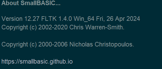

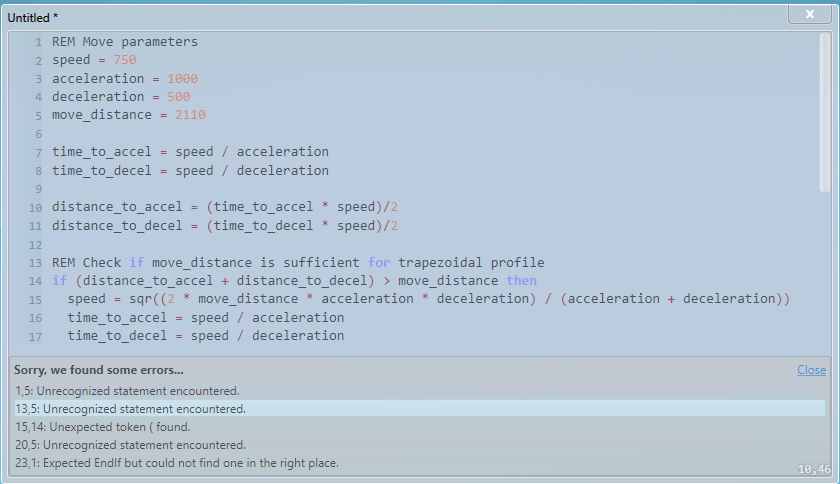

    Ok, so That looks really good, but I just downloaded Small Basic to play with it easily and there are difficulties, Your code looks perfectly understandable and runnable to me, but MS Small basic disagrees in ways that make no sense.. is there something special about your settings or maybe some 'other' small basic?
    Ok, Smallbasic is NOT Microsoft Small Basic.. The world makes sense again..
    Thanks Much @Mickster
  • :D
    A common problem which is why my screen grab included the icon.
    This is an interpreter but can be "packaged" to a .exe

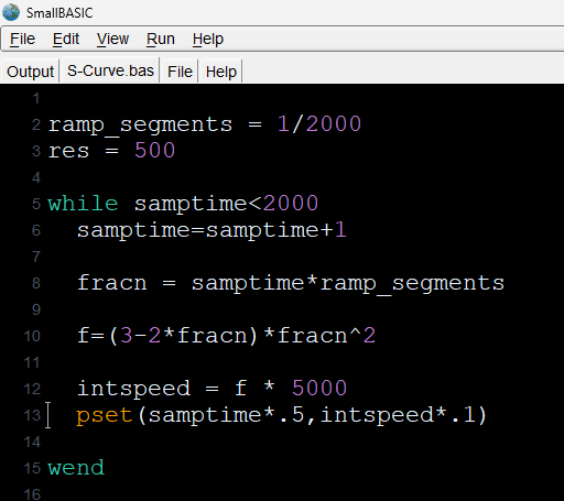

    Huh?
    Is this yours or mine?
    Looks identical to what I do but I don't remember uploading this :o
  • R BaggettR Baggett Posts: 272
    edited 2025-08-20 16:12
    @Mickster said:
    Huh?
    I swiped it from the code window in the link you provided in your first answer. The one where I looked at the deceptively simple math and the title including 'trapezoidal' then concluded this wasn't an "S" curve... ;)
    Magritte would be proud!
