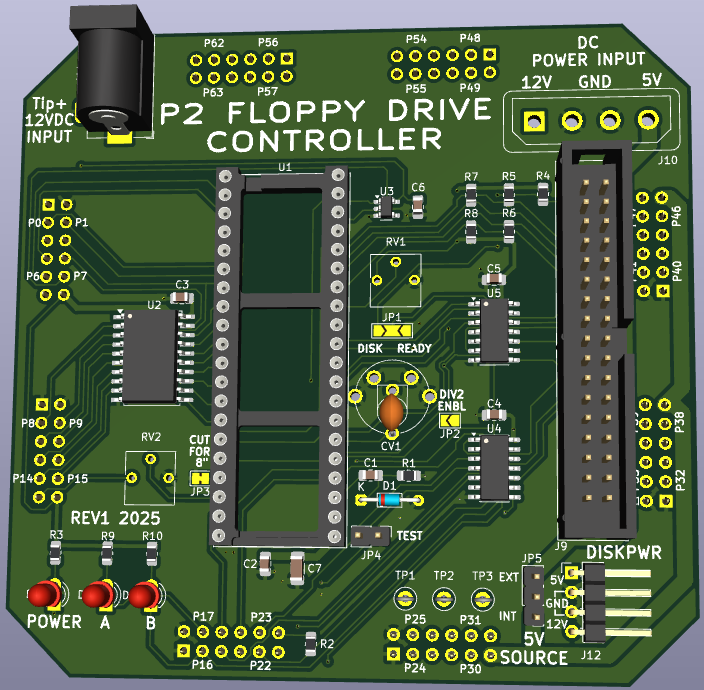

So here's an old school project for the P2... :smile:
I have just finished designing a PCB for the P2-EVAL which in theory should be able to read/write from old floppy disks using a P2. I did this as I am intending to eventually have a full P2 emulation of a Microbee Z80 machine from the 80's (for another project) and as part of that I want to be able to figure out the floppy disk interface using a P2 and then create some disk images from old floppies I own. Or I might potentially even keep this same HW design present in the final emulated system connected up to real P2 IO pins (along with a Z80 PIO chip). So this is both a learning exercise for me and a tool at the same time.
Here's the board render (a few parts are missing their 3D models). It uses a WD2793 controller chip as the core component and interfaces to the P2 using typical async bus signals with some 3.3V level conversion on the data bus towards the P2 using a 74LVC245. The other parts are just 74LS open collector drivers which drive the floppy disk and handily also work with 3.3V control signals where needed.
The disk drive's power can be sourced by an external 5V & 12V DC supply using a typical 4 pin Molex receptacle which gets passed through to the 4 pin Berg connector for the 3.5" drive. There is also an option for feeding 5V only from the P2-EVAL with the extra 2A USB input source in cases where 12V is not needed (e.g modern 3.5" floppy drives), or another scenario where 12V only is input via DC barrel jack and 5V gets supplied by the P2-EVAL. This board and controller will probably even work with the older 5.25" drives too, with suitable power cabling adapters (Berg to Molex) although that is not my own application.

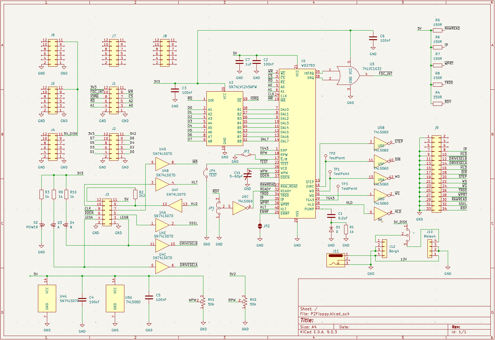

The schematic is provided below.
The PCB should get made in the next few days with help from @Tubular and I may see it back next week with any luck. Probably need to think about component ordering now...
If there's any interest from others I may decide to share the KiCad design files, although sourcing the older parts is not that easy, particularly the controller, and even the trimmer cap (which seems to be getting more obsolete these days, not surprisingly with the whole digital revolution we've had).

    Ooops, last minute fix. Needed a pullup resistor on one open collector output driver to the READY input. Luckily the board had not been fully submitted (was just about to be according to Lachlan) and I could fix it in 5mins. Doh! Other o/c signals have pullups inside the WD2793.

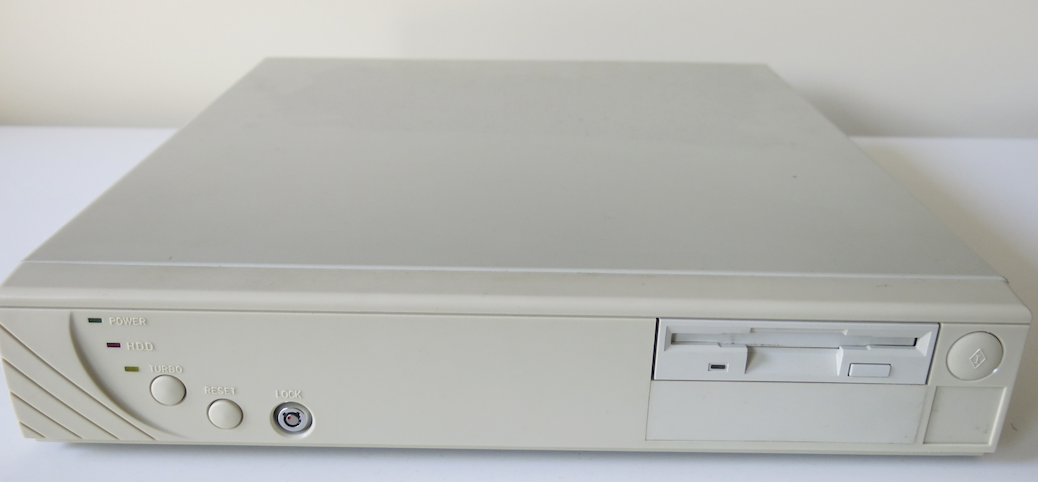

    Yeah this controller apparently even suits some of the older 8" drives as well and in fact the FDD interface the Microbee uses is indeed the Shugart standard vs the IBM PC standard (a slight variation in selection of drive selects and other minor details but I was still able to use a modern Sony 3.5" FDD on the old Z80 machine with some simple wiring mods and cable twists). I've added both A & B drive selects for this project so hopefully two drives could work with it using the whole cable twist thing - the single motor on signal is still shared FWIW, but the two drives would have different drive select signals - the Microbee actually has 4 and used a couple of different pins to the FDC for selecting drives C&D and only one motor on signal. With an open collector bus no real electrical dramas happen if multiple drives try to output their data at the same time - it just won't work.

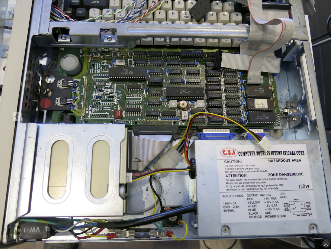

    Here's a pic of old my Microbee (I transplanted into a old PC case) showing the floppy disk interface.
    I also have plans to add a Gotek floppy emulator which I have kicking around somewhere to this too but that will also still need the same floppy disk interface to write images to.

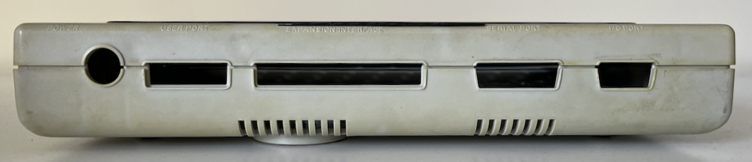

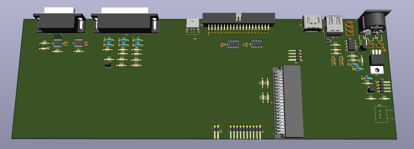

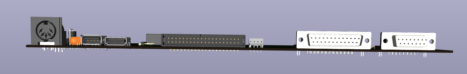

    So for a laugh while waiting for my boards to come back I messed about in KiCad and hacked up a minimalist Microbee circuit design that would use a P2 Edge as the brain which emulates the Z80 and yet retains the existing 5V peripheral IO & connector compatibility externally. This P2 emulator would need to simulate a PIO and FDC (if possible). If that turns out too difficult I would go back to the design that includes these chips on the board and then control the HW via actual IORQ bus signals generated by the P2. But a minimal variant is tempting to target. I already can run a working emulated Microbee inside the P2-EVAL (without floppy or PIO capabilities) which plays games and runs CP/M etc.
    I kept most of the original IO pin mapping but took a couple of liberties in the design by adding the B channel strobe and ready signals on the unused parallel port pins (at least for early implementations), which would allow bi-directional mode operation. Also I added HDMI output for video (instead of composite) and USB-A port (for either a keyboard or a mouse or joystick perhaps). These connectors make use of the empty "user port" cutout on the back of the Microbee case. For convenience I also added a power output connector for a floppy disk drive next to the IDC header. The cassette interface is also still present on the DIN connector.
    This 3d render of the unrouted PCB shows the general idea of what something like this might look like. I'd probably have to tweak this a bit more but still would want to use mostly through hole stuff for keeping that retro feel and ease of constructing it manually.
    Here's my old crusty 'bee case (which could benefit from some cleaning and Retrobrite action), showing the position of the IO connectors. The PCB would fit inside the case (with suitable mounting holes in the right places) and the matrix keyboard that already sits inside the case would be connected as well. I really want to reuse the keycaps from my original keyboard and refit all the keys with modern day keyswitches - problem is that the keycaps need some stem adapters to attach them. They can be 3d printed but are a bit of a PITA to get right apparently.

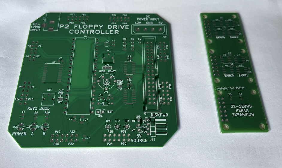

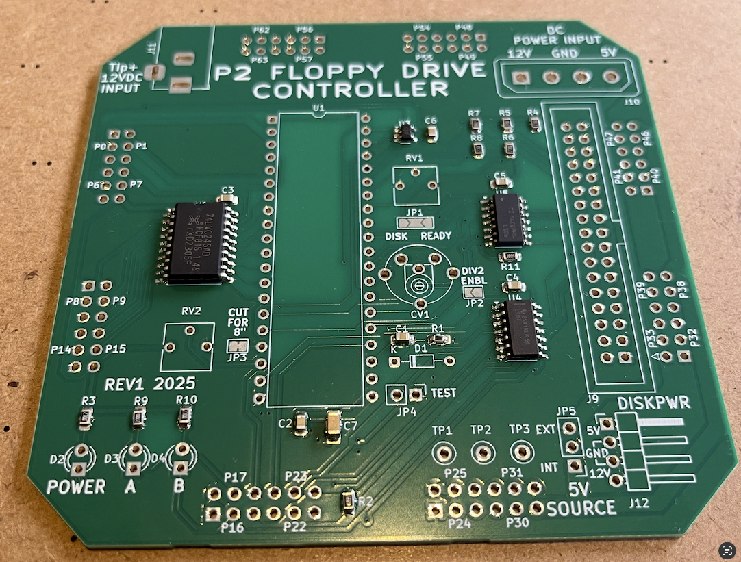

    I picked up my boards today from @Tubular (thanks!)
    Looking decent. These are my first boards ever done using KiCad and I'm happy that it has worked out so far. I used Eagle before this for all my PCBs and was coupled to it for too long with mental inertia etc, but now I can finally break free and make larger boards with more layers and I'm finding KiCad 9 pretty straightforward to use. Apparently it's much better now and easier to use in later versions vs the earlier ones. I didn't encounter any real dramas using it yet.
    Through hole parts I collected seem to fit fine. Just need to solder it all up to test and then write some register access code to try to read floppy sectors etc.

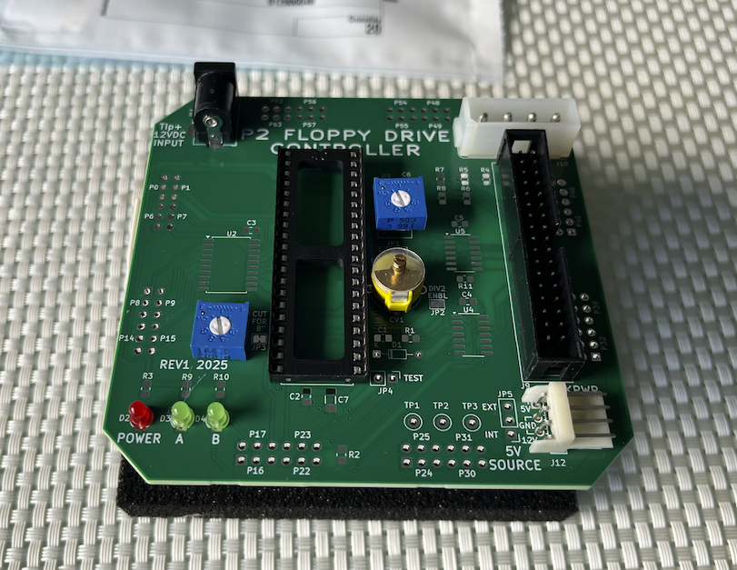

    Nah, just an optical illusion and parts were placed only for checking the fit. Will be soldering it up today though now the paste has warmed up. I want to do the SMD passives & the SOICs on the hotplate first then the through hole stuff.
  • roglohrogloh Posts: 6,194
    Board seemed to cook up okay on the hotplate, although I've been deceived before and will need to check with the video microscope.

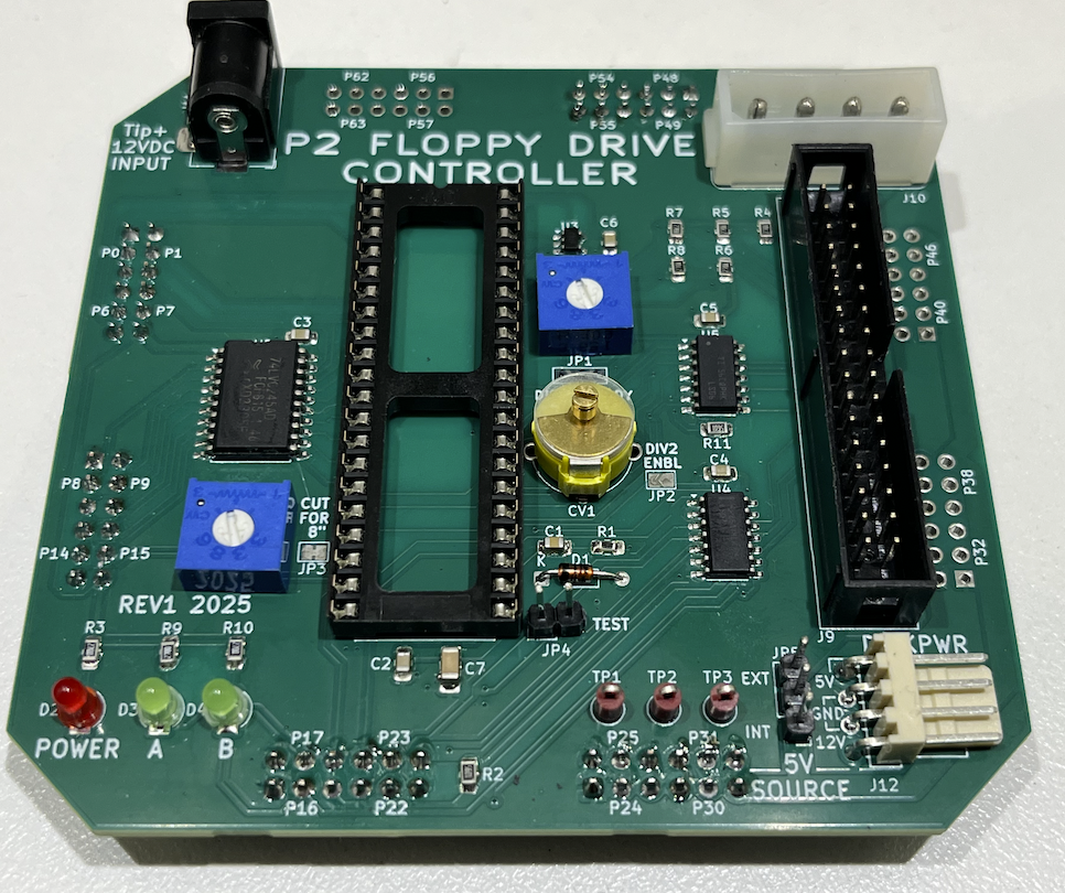

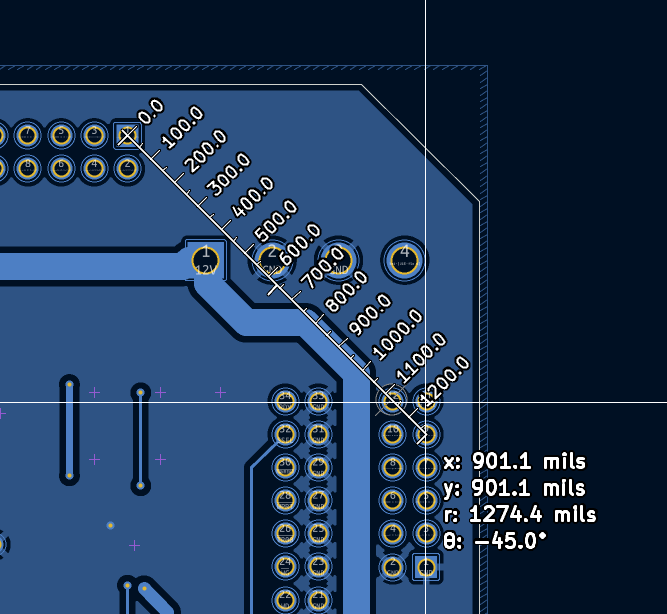

    Well I soldered it up then discovered a (partial) f-up. Thankfully I can recover and still use this board. Turns out my P2-EVAL footprint spacing on my PCB was off by 0.1 inch down one side when I layed it out and my obviously non-thorough double checking efforts didn't find it. Doh!
    It's okay though because I don't use these P32-P47 pins for data on my board and in fact it would be good to leave some free breakout groups for USB & video boards to co-exist with this for my Z80 emulator debug etc. I did use two of the pins for the internal 5V supply option (plus a third one from P24-P31), so if the 5V floppy drive current through one single pin header pin exceeds the P2-EVALs 5V supply output in that area it might get warm on that last trace. But I can always use the external Molex supply if that is an issue. So I'm not concerned about it and it's just an annoyance rather than anything too problematic. I just left off the headers for P32-P47 (plus P56-P63) which makes it easier to separate the boards. With all 8 headers fitted it is tight and gets difficult to pull them apart.
    Here's the final completely soldered up board. Now need to start testing and coding.
