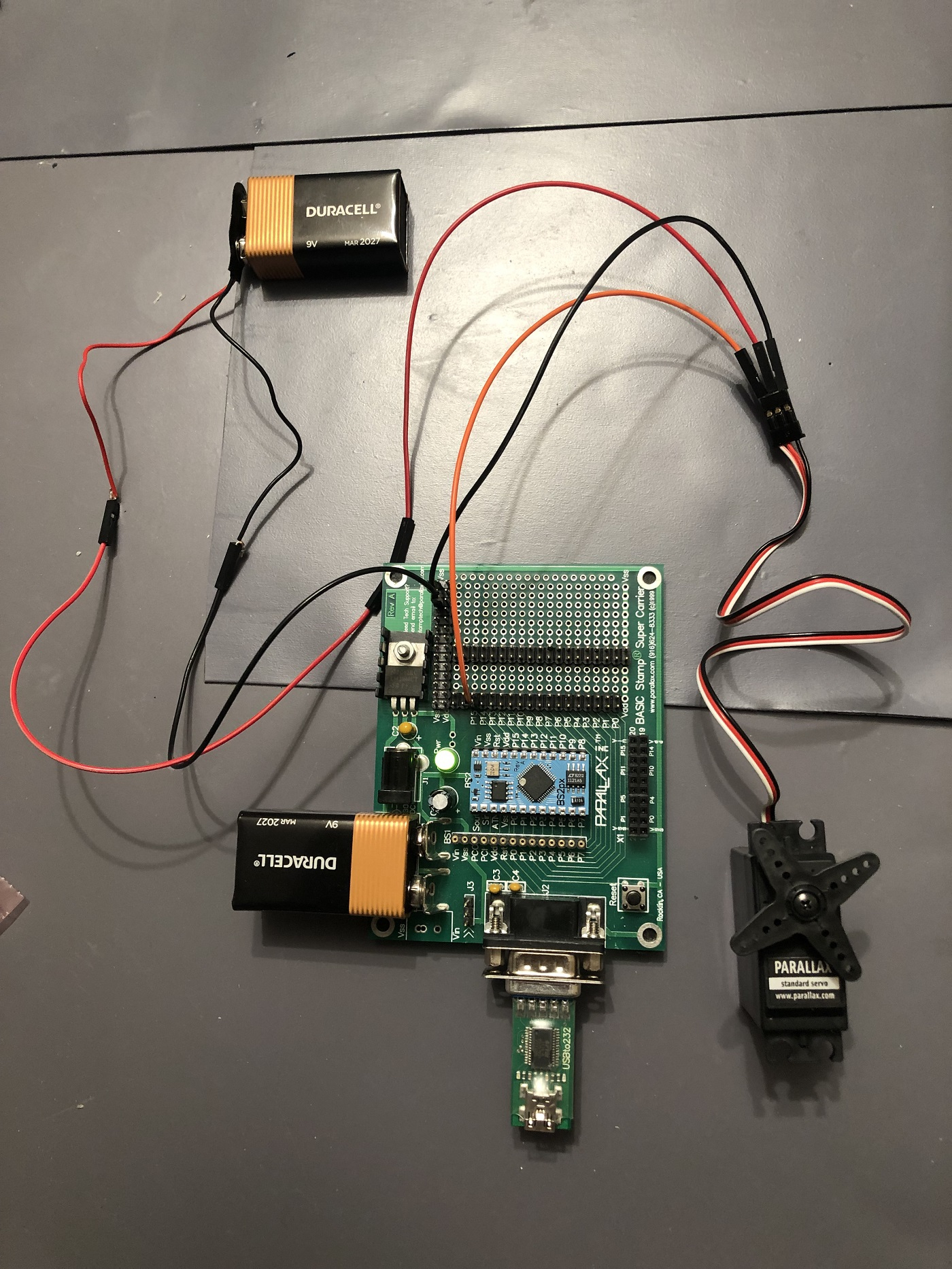

Hello,
I set up a very basic instruction of moving a parallax servo to about 90 deg and back to 0 deg after 5 seconds.
The processor and servo moved as expected, but a few seconds later and sometimes after a minute or two (randomly) it re-run the program by itself and the servo will move following the program.
Do you know why this can happen randomly?
Thanks

  • Hello Jon,

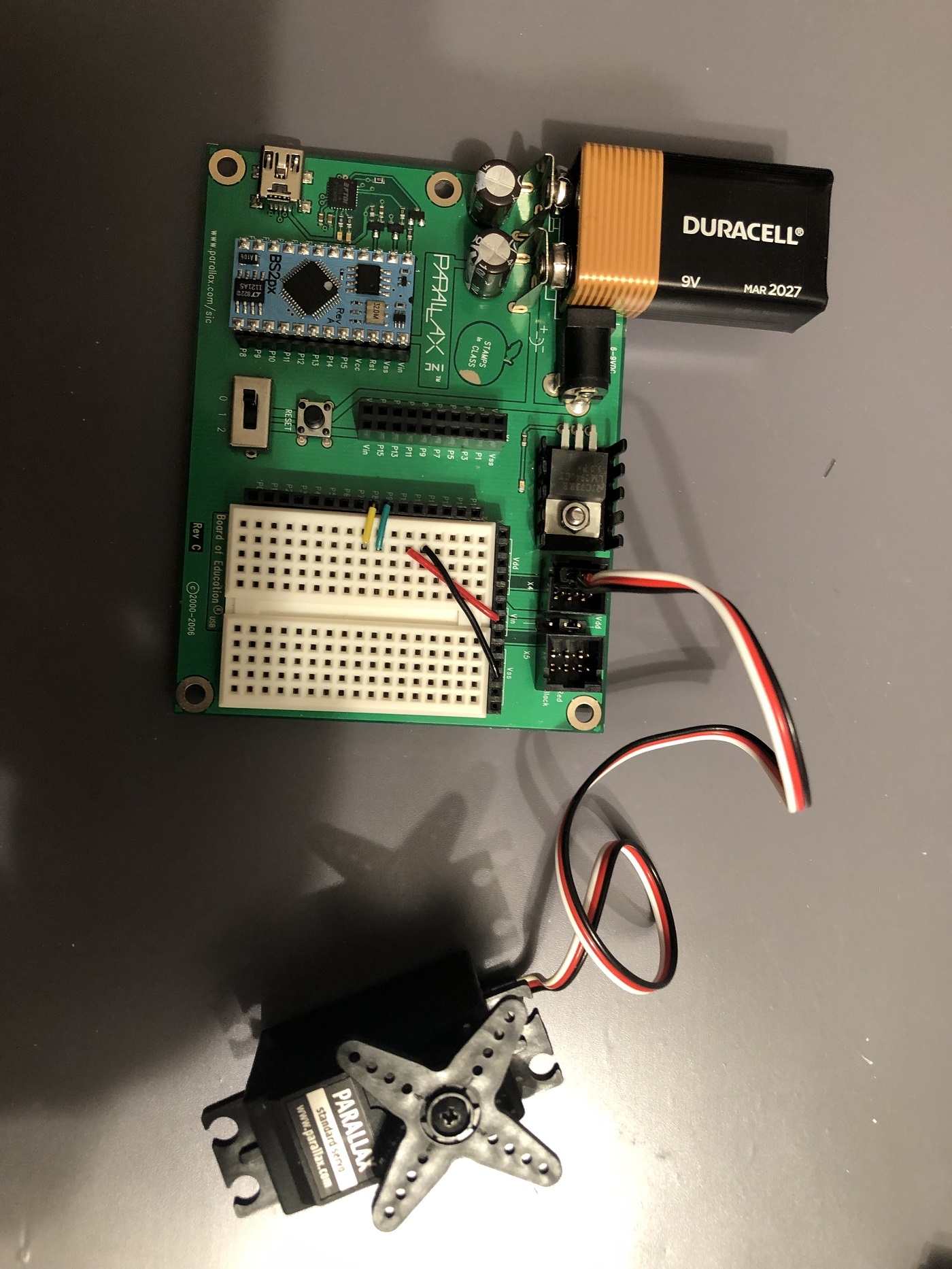

    Thank you for your reply, I checked all connections and made sure that the batteries are ok. I'm using a separate battery as I'm using the board (super carrier)
    I then changed to the board of education Rev C with a fresh BS2px and a different servo but the same thing happened. I thought because this board has the actual servo sockets will help, but it didn't
    The code is:
    ($Stamp BS2px)
    ($PBasic 2.5)
    Counter VAR Word
    For Counter =1 to 800
    Pulsout 15, 1000
    Pause 20
    Next
    For Counter =1 to 200
    Pulsout 15, 2125
    Pause 20
    Next
    END
    This move the servo nicely 90 degrees, hold it for about 15-16 seconds and return it to the same position.
    The problem it starts repeating the program like 3 or 4 times randomly. The majority of the time it re start the code like every 30-38 seconds after it concluded.
    After those repetitions it eventually stops and never moves again. I removed the "END" at the end of the code to see it it was going to help but it did the same.
    Thanks
  • JonnyMacJonnyMac Posts: 9,440
    edited 2025-08-09 23:06
    Change END to STOP and that should fix the problem (see the help file to learn why).

  • It works with the "stop"
    I did most of the exercises of what is a microcontroller book and never came across the instruction "stop"
    Thank you!
