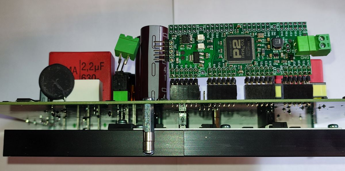

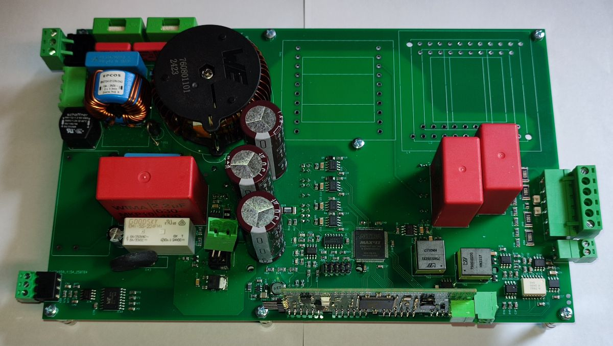

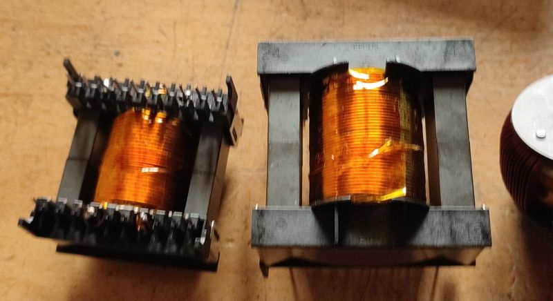

  • I've just assembled the first prototype.
    The power transformer and the output choke are still missing. I first have to test the rest of the circuit.
    The power semiconductors are located on the bottom side on the heatsink.
    I decided to use a KISS board as plug-in card instead of soldering the P2 directly on the main board. This saves some space and it's easier to connect a scope to the pins in the case I need it. And it's easier to replace if I burn something.
