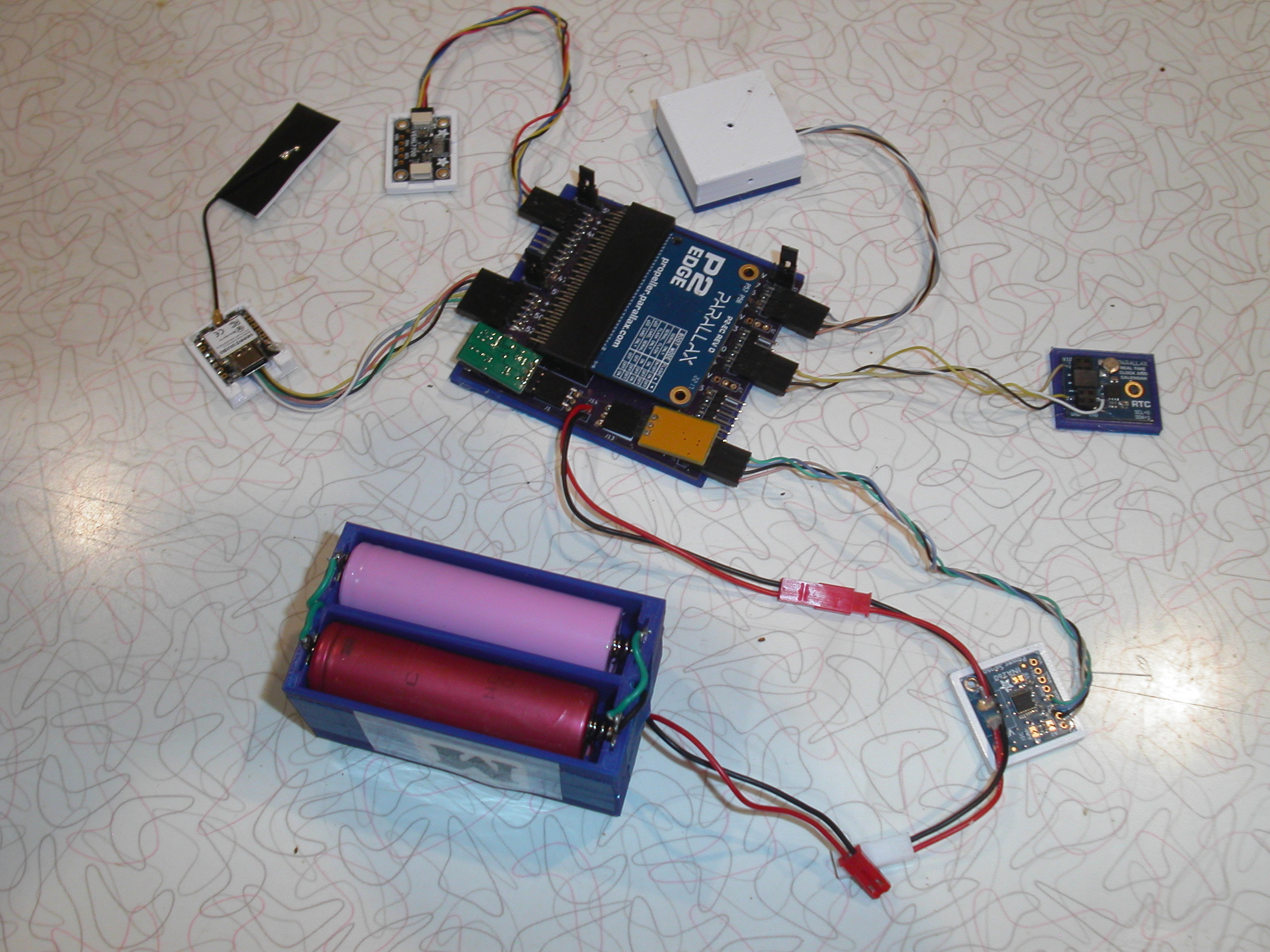

  • Just an up date on this project, yes it turned into a larger project than anticipated. I have eight BME680 stations, consisting of, an Rpi3 using Python, and a BME680.
    One sta is outside logging the streaming data. The attic sta is also logging streaming data. And so are the stations in the basement, kitchen, bedroom, living room, study, and sun room. I have all the data being submitted to my SQLite database for detailed analysis.
    The purpose for all this, I wanted to get an idea of what the differences are through out the house.
    On the software side, it would be nice to implement some form of agentic. I wonder if the P2 could be made to be a mini agent.
    Now I have to learn how to really use SQL and pandas for analytics.
    Ray

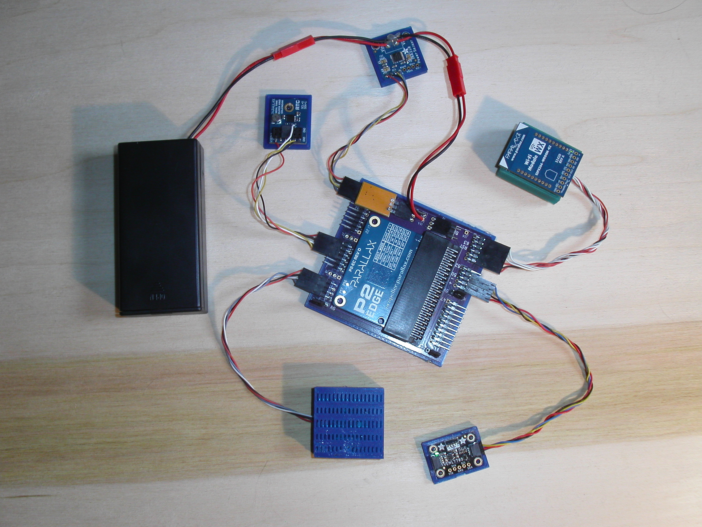

  • I am sort of satisfied with the setup of this project. But, it is getting to be a hassle trying to automate the capture of all the data, on different units, and having it data logged for processing of the data.
    I am trying to get to a point where my server talks to the individual sensor units, gets some specific data, and proceeds with a report and/or supplies a web page with the data. And the server just might have to do some specific mechanical function with the specific data that was acquired.
    I was thinking about implementing the P2 or the P1, but Parallax does not offer any type of off the shelf material that could replicate my current setup.
    Ray

  • Since the P1 Activity board is now gone, I do not see myself fiddling around with the FLiP. So, that leaves the P2 as an option.
    So I am thinking how to I get communication with a P2 unit via a LAN or WiFi and my server unit. The idea is to replicate my Raspberry pi BME680 setup using some sort of P2 unit setup. Simple IDE does not support the P2, so that eliminates a lot of established code. If I add the WX WiFi SIP module, I think that there is a lot of limitations with the existing firmware that is available. Can the P2 unit with a WiFi module be setup to make a connection with another unit allowing for access to the P2, I guess a small OS would be needed. The OS, of course, would not be a linux or anything like that.
    OK time to wake up and get something going...
    Ray

  • P2 works just fine. You can configure a URL on the WiFi module and send it a request, and it will respond with the weather data.
    http://weather/weather
    {"time":1756442304, "voltage":8042, "current":26, "temperature":2775, "humidity":6713, "pressure":2939, "light":208}
    I use Visual Studio Code as my IDE and then compile it with flexprop to load onto the P2. I started with the P1 but found the P2 uses less power. The code is almost identical between them.
    Standard WiFi module.
    Using an ESP32 module with update WiFi code. The ESP32 module uses less power.
