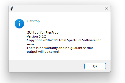

    So I found FlexProp 5.5.2 archived in my DropBox and now I have success :+1:
    What am I to deduce? Edge Rev B not compatible with newer FlexProp? I don't see that being the case. :|

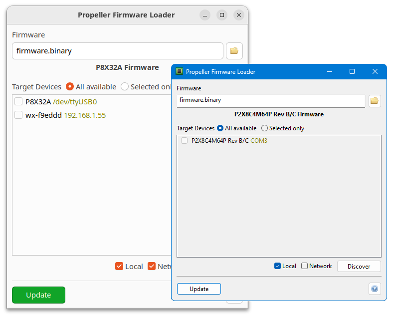

    That said, @macca has another tool that is a GUI loader for precompiled modules. This was made to help developers help their customers. You can get it from Marco's web site: https://maccasoft.com/en/propeller-firmware-loader/

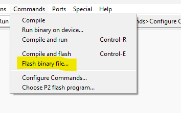

  • ersmithersmith Posts: 6,193
    It looks like something is broken in the flash programmer in loadp2 for Windows, which is weird: I don't know how we've missed that.
    Fortunately, proploader can also program flash, so on the command line you can do something like:
    bin/proploader.exe -2 -Dbaud-rate=230400 -e blink.binary -t
    to flash and run a program like "blink.binary".
    You can also use the FlexProp GUI to do this if you go to "Commands > Configure Commands" and change the "Flash command" string to:
    "%D/bin/proploader" -k -2 -Dbaud-rate=%r %P "%B" -e
    (which is very similar to the "Wifi run command" just above it, but with -e for "flash eeprom" instead of -r for "run serial", and without the %9 -q)

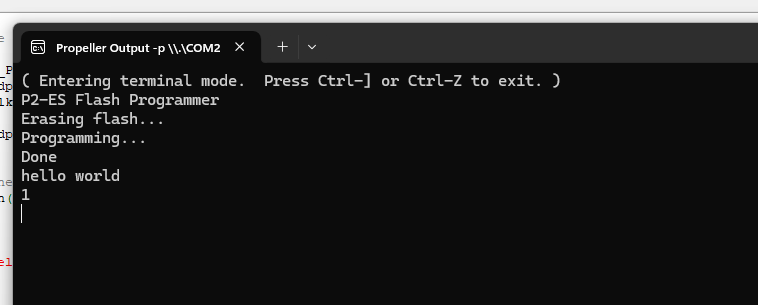

    PS: Tested with -FLASH, and -v to get any reporting ...
    trying /dev/serial/by-id/usb-Parallax_Inc._Propeller_P2-EVAL-ES_DN43WU6I-if00-port0...
    P2 version G found on serial port /dev/serial/by-id/usb-Parallax_Inc._Propeller_P2-EVAL-ES_DN43WU6I-if00-port0
    Setting load mode to CHIP
    Setting clock_mode to 12427f8
    Loading fast loader...
    address=0x000fc000 size=2ac
    device response to header: `s'
    chksum: 3a OK
    Loading eeprom_check.binary - 8372 bytes
    address=0x00000000 size=20b4
    chksum: e7 OK
    highest hub address: 0x20b4 chksum: 0xea4ce5e4
    address=0x80000000 size=400
    device response to header: `k'
    Sending blocks: .chksum: 8e OK
    sending F 0x000020b4 to device
    ( Entering terminal mode.  Press Ctrl-] or Ctrl-Z to exit. )
       clkfreq = 20000000   clkmode = 0x100094b
      Compiled with FlexC v7.4.1-beta-v7.4.0-3-gd3cadbe0
    And pressing reset button repeats the terminal prints, so successful test.
    Bingo :):+1:
