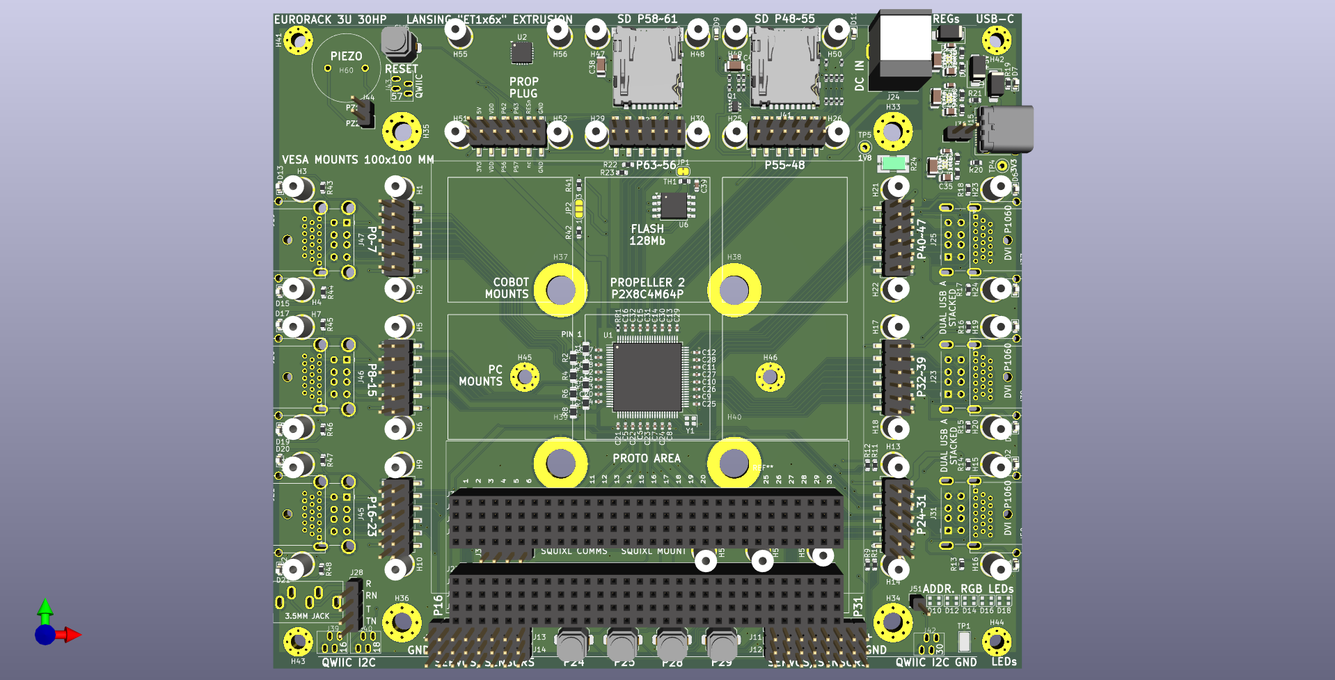

I've been working on a factory floor R&D project that currently involves both a P2 and PC. In the medium/long term, it would be good for the P2 to take over most functions from the PC, especially the time-critical ones
The attached design is what I've come up with. It sits somewhere in between P2-eval, the P1 demo board, and the P1 PPDB. The 88x88mm area in the middle can be for the PC we currently use, a Blackview MP80, or my friend unexpectedmaker's "Squixl" ESP32 based touch display, or a Proto area.
The Blackview has three HDMI sockets on left, and three USB 3 type A sockets on right side. It has two RJ45 lan sockets and power in at the top. I wanted to preserve roughly the same cable setup, but realised I can triple-footprint each 8 bit port to have
  • a P2 accessory header, with solder nuts for securing boards or 1"x1" sparkfun sensors
  • a dual stacked USB A, with 2 leds, compatible with the serial host accessory board
  • a through hole HDMI/DVI connector we can buy locally (seem rare elsewhere)
There's other stuff on the board, most can be jumpered/patched in as required.
As for mounting there are at least 4 options
  • Vesa 100x100 to mount on back of monitors
  • Cobot mount (M6 bolts, 50mm PCD) - eg Universal Robots
  • Eurorack ~ 3U 30HP
  • Lansing 'ET' type AL extrusion, 6" long, connectors at ends
The Blackview connectors are all elevated quite high in its case, allowing the P2 boards to happily sit under any PC connections.
Once this board is settled I'm going to compact version, working codename is "brady bunch" because it'll have the P2 in the middle and the 8 sockets packed all around. In this scenario the P2 boards and connections effectively fit on top of the upside-down PC, for a compact 88x88mm overall footprint. You can see the squares in the render.

    I forgot to mention a couple of other features
    • after discussion with Rogloh I incorporated his SD card and power fet(s) design on P48~55, thanks Roger
    • there's 4 'qwiic' connector footprints slotted around, for the through hole SR/SZ headers. The slots allow either side or top entry versions to be used as these have slightly different hole requirements
    • 3.5mm TRS audio phono socket with optional switches at bottom left ready to patch in
    • Four WS2812B addressible leds at bottom right
    • 10mOhm current measuring resistor on VDD (in green)

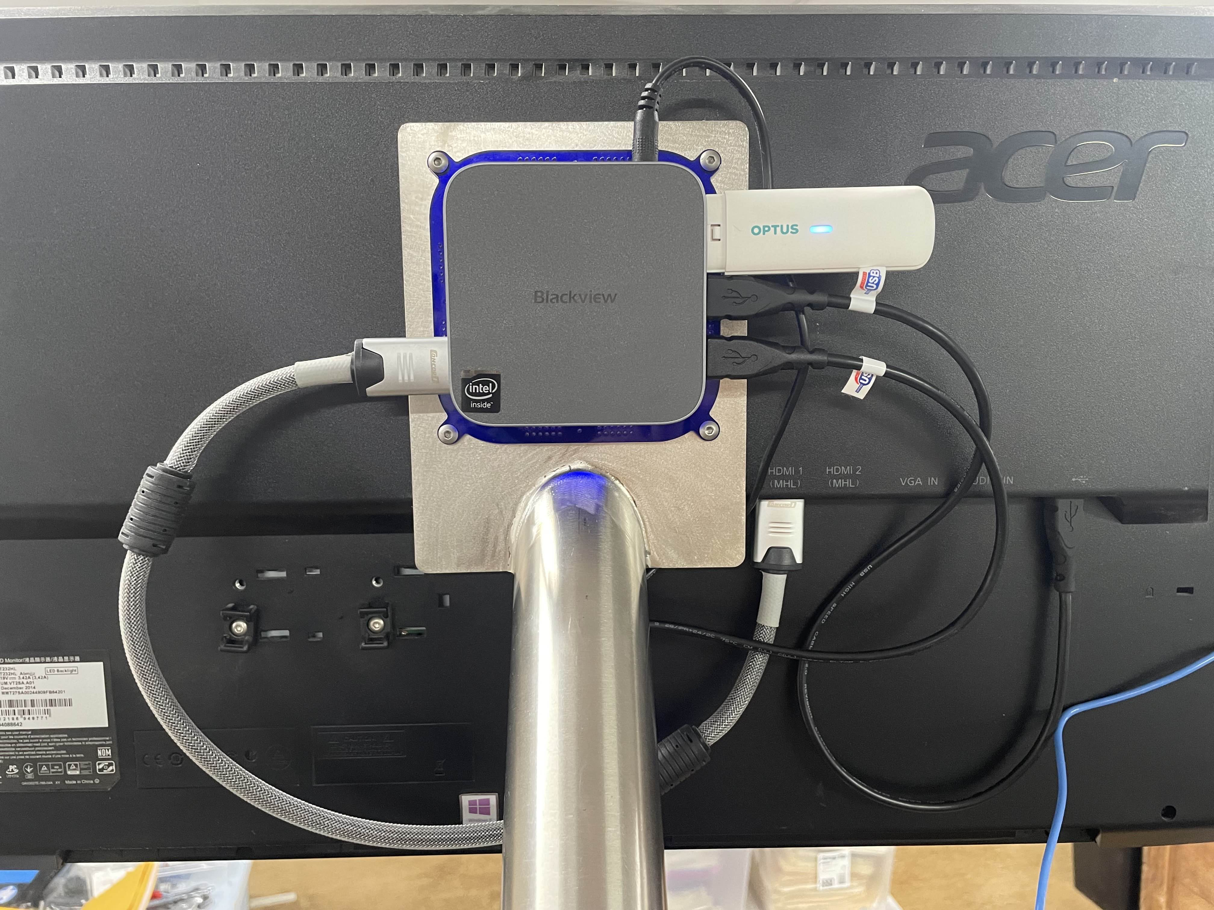

    Here's the earlier setup with the PC attached on the back of a touch screen monitor. The blue lasercut acrylic has holes where I was originally thinking of installing P2 accessory headers, before realising 3-a-side was more useful than copying P2eval
    The Blackview MP80 is almost exactly the same size as P2-eval.

    This will be a nice board design to have around @Tubular . Glad you switched to switching regs for higher voltage operation. I can already see myself wanting to make a handy PSRAM expansion board for the triple wide Parallax expansion header layout down one side, with multiple chip selects on the first 8 IO pins and the 16 bit data on the upper 16 pins. Or you could use the Parallax HyperRAM board instead if that also still fits. Even with some external RAM fitted the other side would still be fully free for HDMI/VGA/USB/Audio/general IO use.
    It offers a pretty useful setup and could replace the need for the now retiring P2-EVAL to some extent. Having some IO connector layouts like HDMI and USB already down on the board is great, especially if you get to solder them in yourself only when needed. The VESA mount is a nice touch too.
    So when do you reckon you'll be getting your design sent out for your first test boards to be made?

    Yeah I really like the capability of these switching regs, they are TPS82130 and rated up to 3 amps which is pretty useful. Up to 17v input so useful for "12V" battery systems
    Would love to see a bigger PSram board if you make one. Yes the parallax Hyperram board should fit, the connectors are on standard 1.1" centres, but I might make a small lasercut plastic shim to prevent anything shorting on the solder nuts I'm using
    Likely to send something out tonight or at latest at the end of the weekend. I have a friend who wants to send something off and share dhl shipping. Did you want to have a quick go at a psram board?

    Speaking of which those 1 inch square nut patterns seem to occlude the actual Parallax expansion headers from wire jumpering from them to any SparkFun sensor boards fitted directly above, if that was your intent. You may need to offset these away from the 6x2 pin 0.1 inch headers slightly. Or was there another plan for attaching connections to these sensor boards?
    Cool. I'll probably try to whip something up soon but am currently finishing up another project this weekend so it probably would not make your next deadline. Might have to go into a later PCB order. Which if any P24-P31 pins are currently routed for something else...? I may want to avoid those for the high speed clocks for example.
    Unfortunately there's quite a few variants of the 0.1" headers on the sparkfun sensor boards, I made a list of the variants but need to draw up. Connecting via qwiic/stemma qt is an option but it'd be good to have something more friendly and tidy
    I went for a walk this arvo and resolved to improve P24..31 so we can do memory things. Those connections meander a bit (the buttons down the bottom are on that headers, so too are half the servo connectors). I'll move things across to P16..23 to keep that right side fast. Also getting some grounds in between signals where I can
