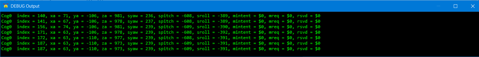

Been toying with this 9DOF sensor from Sparkfun with BNO086.
Was initially looking at I2C interface, but this was looking a bit daunting.
Then, read about this RVC mode (robot vacuum cleaner).
This is dirt simple, it just outputs the data I need at 115200 baud at rate of 100 Hz.
All needed to do was solder bridge the "PS0" solder jumper on the back of the board.
Even better, the data comes out on the same wire as the I2C SCL, so can still use the QWIIC cable to connect with.
The robot want to use this for isn't a vacuum cleaner, but I guess it's a very similar thing, so should be perfect.
This code reads the serial packets and shows the data in Prop Tool's debug window.

    I found a cheap BNO085 on Amazon and tested my theory (no cog needed) -- seems to work. I haven't read the docs carefully but I'm not sure that the MI data is available in RVC mode. The '085 doesn't have this anyway, so it just sends 0s. The serial packet is the same length as your '086 code.
    v1.0.1 Fixed display error and added version to banner
    v1.1.0 Added calibration for accelerometers

    Hmm… z and y accel shouldn’t both be one? Think sum of squares of all accel should be one.
  • JonnyMacJonnyMac Posts: 9,376
    edited 2025-07-01 12:33
    I had a copy/paste error in the display section. Fixed it and reposted.
    The values from my code seem to match your code.

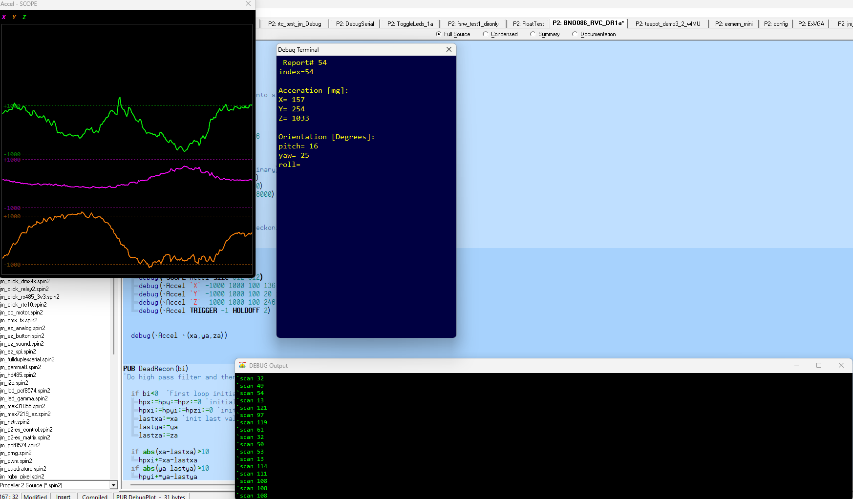

    Done some more testing... Here's maybe a more useful version of the code.
    A little disappointed that the RVC mode data doesn't include input from the magnetometer.
    Actually, what processing is actually done in RVC mode does is not documented?
    Still, might be good enough for robots...
  • RaymanRayman Posts: 15,364
    edited 2025-07-07 21:33
    Trying to see if there's an easy way to implement dead reckoning. Probably isn't but trying anyway...
    The debug "Scope" window is actually useful for this case.

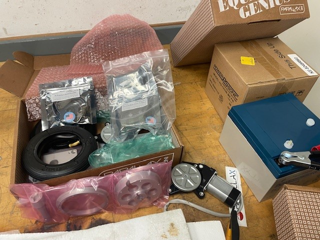

    Got some of the Parallax 12V wheels 'cause were 50% off.
    Was thinking regular bot.
    But now, wondering if this sensor in RVC mode is good enough to make a self balancing bot...
    Not sure if this giant battery is good or bad for that application.
    Was thinking 3-wheel bot with caster wheel before...
    Guess can try and revert if doesn't work...
