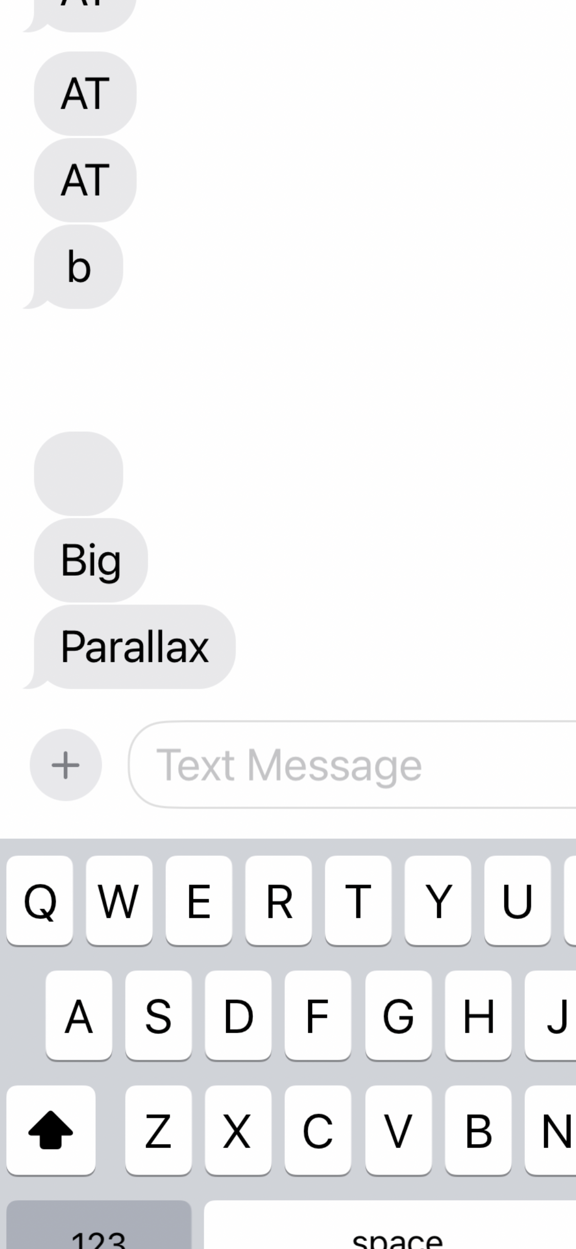

  • I pulled mine out of the box and its still working. Open Xctu, discover modules, update firmware etc.. In settings you'll have to check for the modules phone number, ICCID, IMEI, etc. that's in the config settings. In network SMS. Skip remote go to addressing, put in the destination phone number. Hit the read should you an AT to your phone. Switch to console click plug looking thing top left for close. Write in console log something like Hi, hello etc.. Now write Hi, hello in the send packets, hit the plus + sign write hi in ASII.. Click send single packet.
    Go back to settings hit write. Back to console mode write messages and read and write what you send from your phone in the console log.
    Fresh out of the box you'll have set it up, you might have to call Xbee etc.

  • Some examples, Had another Jpeg of the console, but won't load for some reason
    1125 x 2436 - 1M
