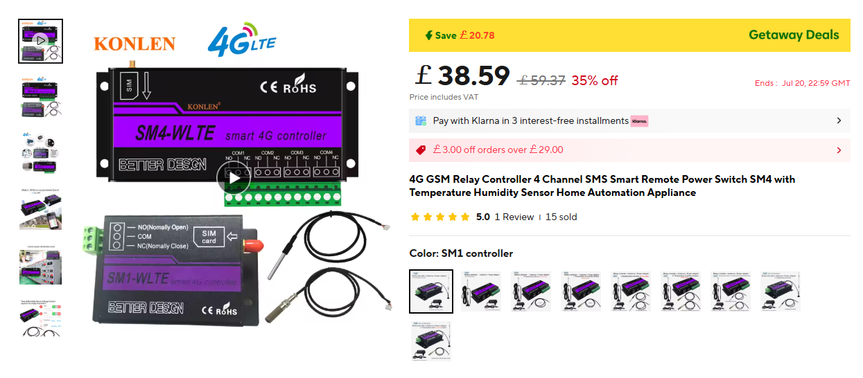

  • MicksterMickster Posts: 2,885
    I'm not the best at interpreting what's really needed but:
