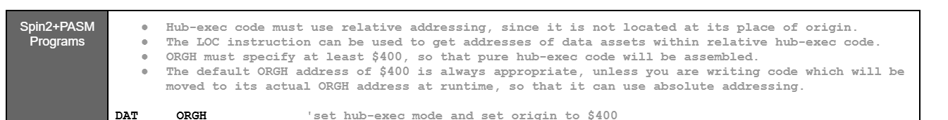

Where can I find docu about all these address symbols?
org, orgh, $, @@@, @
When do I use what?
Is this correct:
@@@ gives an absolute address in HUB
This statement from the SPIN2 docu seems to be wrong, at least when you use orgh a second time?!!!?
The following program seems to place the luttable correctly into LUT but the branch seems to crash.
I assume, this has to do with "long (progstart-$) ' relative distance" ?
Any help appreciated!

  • @@@sym always means the absolute address of symbol sym. @sym means that for a pure assembly program, but for a mixed Spin2/PASM program it means the address relative to the start of the object.
    IIRC @ and @@@ end up meaning the same thing in flexspin Spin2 code. In Spin1 they're different, and I think in PNut there is no @@@ (and @ has the same meaning for pure assembly programs, but not for mixed Spin2 and PASM).
    $ means the address of the current instruction or data item.
    ORG and ORG 0 both mean the same thing (start assembling code that will be loaded into COG memory at address 0).
    ORGH means to stop assuming code will be in COG memory, and assume it will be in hub memory instead (the H stands for HUB). In pure assembly programs ORGH on its own is equivalent to ORGH $400 (just like ORG is equivalent to ORG 0) but in mixed language programs that is not the case, because it's not possible to place code at arbitrary hub addresses; in this case ORGH just means "resume assembling for HUB at the current HUB address".

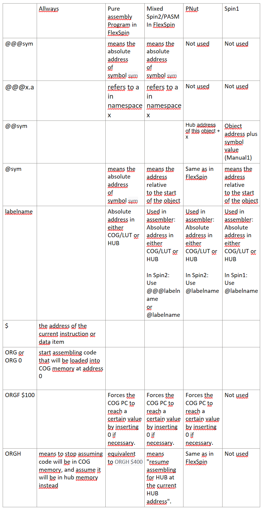

    So I tried to make a table about these things:
  • @"Christof Eb." I've been reluctant to try to write an assembly language manual because (1) it's a lot of work, and (2) Parallax has been working on one for a while now. The P1 manual is pretty good, so I hope the P2 version is finished soon (I think a preliminary version is available, somewhere behind the P2 Docs button).
    I'm pretty sure that all got changed to match PNut, didn't it?
    (PNut does not have the triple-@ operator due to how it links objects...)
  • @Wuerfel_21 said:
    I think you're right, it's been a while since I looked at this. Flexspin has to match PNut as much as possible, so @ on its own does mean "address relative to start of object". For a PASM only project the "object" starts at address 0, so @ and @@@ evaluate to the same value. The reason for the triple @@@ is that it combines single @ (address relative to start of object) with double @@ (base address of object) to get the real address of the symbol.
