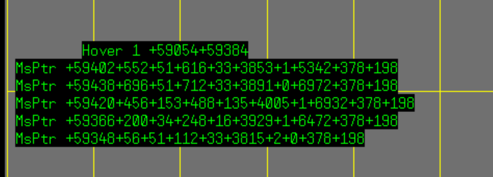

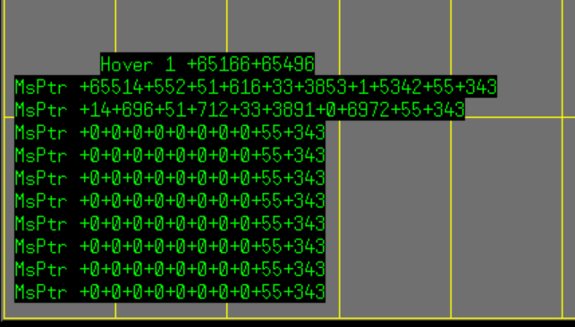

    Debugging the issue with Array size:
    I have a rather complex program using 7 COGs, the original P1 version worked for more than a decade, limited by space and speed. This program is moved to the P2, needed only little modification, some systematically, others more difficult to find. Now I face this situation:
    There is a set of buffers, normally 1k of LONGs. Now, that the functions mostly work, I tried to extend the buffer and it came to a stall of the display process. Carefully adjusting the buffer size I could find the limit. Adding another line of code stalled the program again, reducing buffer size brought the program to life again.
    Setting breakpoints I realized, that the screen-routine stalls indeed and finally I realized, the DAT section of the screen process is corrupted.
    This is data dumped when OK:
    and this is when something goes wrong:
    I use Propeller Tool 2.9.3, but had the same result using the current pnut
  • ErNaErNa Posts: 1,855
    edited 2025-05-21 16:16
    OK: could be, I use word pointers, and that is just not enough using more than 64K! And the problem arises obviously the moment, the local data is stored at higher memory addresses
    YES, that did the job!

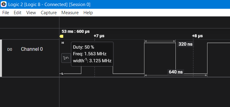

    This is strange:
      clkset (clkmode_, clkfreq_)
      dirb[7] := 1
      repeat
        outb[7] := 1
        outb[7]:= 0
    I expect Pin 39 to toggle: but he is reluctant!
  • JonnyMacJonnyMac Posts: 9,814
    edited 2025-05-28 14:59
    If you're going to do it in Spin2, why not be obvious about it?
      repeat
        pintoggle(39)
    dirb and outb are registers in the interpreter.
    This is what I get when running the P2 at 200MHz.
