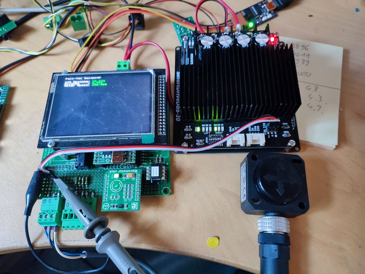

  • I finally decided to use a off-the shelf Cytron motor controller instead of doing modifications to the Parallax motor driver board or designing my own board. The Cytron board is for DC motors only and is rated 30A continous and 80A peak. It has internal overcurrent protection so I can't burn things with software bugs. It costs about the same as the Parallax board and is easily setup using DIP switches. It takes 1..2ms RC servo pulses which are easy to generate with only one smart pin.
    The inclination angle is measured by an analogue sensor from DIS sensors.
  • Today we ran the first full scale test. We had some small issues with overshot and oscillations but after reducing P and I gain and increasing D it works quite well.
    Of course, the whole thing is a pendulum and there is a strong tendency for resonance oscillation. With a real crane where the hook is quite heavy it even becomes a double pendulum. I thought about adding anti-resonance filtering but soon gave up. The length of the cable and the varying load make both resonance frequencies variable so the filter should have auto-tuning and everything gets really complicated. I think, a strong D-gain should provide enough anti-phase stimulus and hopefully enough damping.

  • Yes, if this was a rocket-science project with unlimited budget I'd probably build a behavioural model. I can't measure the cable length directly but I have a barometric pressure sensor on-board (see picture in post #8) so I could adapt to changing height above the ground while the load is lifted.
