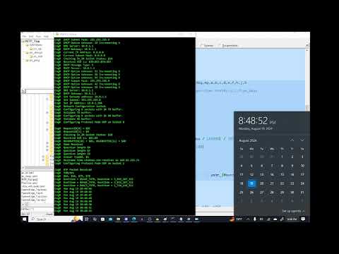

I wrote an NTP client that gets the current date time from an NTP server (time.windows.com). Since the P2 has a boot time counter (in seconds) and a very accurate oscillator, it was very easy to make a clock without additional hardware. Code is attached. It is not good, but a POC. If anyone wants to clean it up, please feel free to.
It will return a unix timestamp. I grabbed a function from AlexGyver's UnixTime.h to parse the timestamp into something humans can read. @Rayman has a nice P1 object called PropTime, but it was more complex than what I needed to parse the timestamp. It looks like it would be the best thing to actually use for a time library. I stole some of his ideas to display the day of week and name of the month.

Thanks @lab_ges! Yeah, getsec() and the system counter makes it possible and doesn't even use a cog. We just need to know the timestamp when the system counter started. I have not put in the work to make it accurate to less than a second or take into account Internet propagation delays. If I have some free time this weekend, I may work on either or both.
That getDateTime function I converted from AlexGyver's C probably needs to be exhaustibly tested. I don't know what range of dates are valid. I suppose I need to build something that will return human readable strings for dayofweek and months.
pub getDateTime(t,tz) : strtime | z,era,doe,yoe,y,doy,mp,a,b,c,d,e,f,h,j,k ' // http://howardhinnant.github.io/date_algorithms.html#civil_from_days t += tz * 3600 second := t // 60 t /= 60 minute := t // 60 t /= 60 hour := t // 24 t /= 24 dayOfWeek := (t + 4) // 7 z := t + 719468 era := z / 146097 doe := z - era * 146097 yoe := (doe - doe / 1460 + doe / 36524 - doe / 146096) / 365 y := yoe + era * 400 doy := doe - (yoe * 365 + yoe / 4 - yoe / 100) mp := (doy * 5 + 2) / 153 day := doy - (mp * 153 + 2) / 5 + 1 month := mp + (mp < 10 ? 3 : -9) y += (month <= 2) year := y debug(zstr_(@daysofweek+((dayofweek-1)*4)), " ", zstr_(@months+((month-1)*4))," ", udec_(day), " ",udec_(hour),":",udec_(minute),":",udec_(second) )Hi Terry @ke4pjw

Yes, you can just put an IP in there of an NTP server and it will work.
I haven't done anything with it. Here is why: In order to derive a sub-second accuracy, it would require computing the time that included the fractional part of the second. NTP is a 32bit fractional counter. The P2 fractional counter is 64bit. The P2 counter is in milliseconds and rolls over once every 49.7 days, while the NTP fractional second is about .2ns and rolls over every second or 1/(2^32). I don't know that I am smart enough to figure out how to derive what that converts to in milliseconds.
@lab_ges Well, Stack Overflow to the rescue. Here is how to convert the NTP fractional seconds to milliseconds. I might take a look at this later this week.
uint32_t frac = (uint32_t) packetBuffer[44] << 24 | (uint32_t) packetBuffer[45] << 16 | (uint32_t) packetBuffer[46] << 8 | (uint32_t) packetBuffer[47] << 0; uint16_t mssec = ((frac >> 7) * 125) >> 22;Hi Terry, Thanks for the comments, very helpful.
