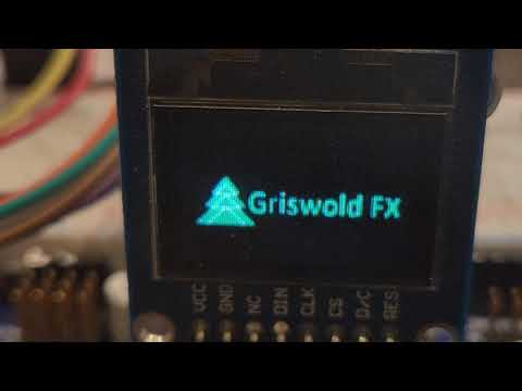

    This is exactly what I do for the bootup screen for my light controllers. I need a pause for the network to settle before actually booting, so while the network is settling, I load a series of frames from the SD card that displays an animation. As I recall the file is much larger than Hub Ram.
    Also as @Rayman suggests above, you can use the flash filesystem as well.
