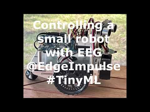

I'd like to wirelessly control an ActivityBot from Python on a PC.
I have a XBee S6B and also a WX ESP8266 WiFi Module + of course an ActivityBot. Haven't used these beauties for years now, and believe I only programmed a PAB through WiFi, but not controlled it.
Anyone knows how to connect from Python to one of these WiFi modules, and control it?
Of course I'd need to have a receiving program at the PAB side (C or Spin), but that should not be a problem once I know how to get the connection going. I found some material at https://learn.parallax.com/tutorials/language/propeller-c/parallax-wx-wi-fi-module-prop-c, but this is mainly about using web pages to control a robot, and only partially applicable to my use case.
In the end, I believe the hardest part will be for me to find the components in my storage boxes :smile:
  • FWIW, I quickly found the XBee S6B and WX ESP8266 modules I have, and decided to use the S6B. Main reason for that is that I used it 8 years ago to control an ActivityBot from iPad and I had already some C-code on the P1 side, basically a collectively developed program, as part of this open project: https://forums.parallax.com/discussion/153214/open-propeller-project-1-ipad-to-activitybot/p1
    I found the below Python skeleton to use on the PC side.
    Now I'm almost able to control the ActivityBot through a consumer grade EEG-headband. If I get this to work more consistently, I'll post a figure-8 video of it :smile:
    Due to the many components involved (my brain => EEG-headband => BlueTooth => phone/phone app => WiFi => PC/Python+TensorFlow => WiFi => ActivityBot), there are some lags, am working on measuring and trying to minimize them. Error handling would also be good to have...

  • Fast forward many months, and here's the final part of this exercise. Not a figure-8, but an Activitybot which I'm mindcontrolling to bring me a cold drink :smile:
    A project write-up of this is found at https://docs.edgeimpulse.com/experts/prototype-and-concept-projects/eeg-data-machine-learning-part-3. Thanks to all in this thread participating in the adventure!
