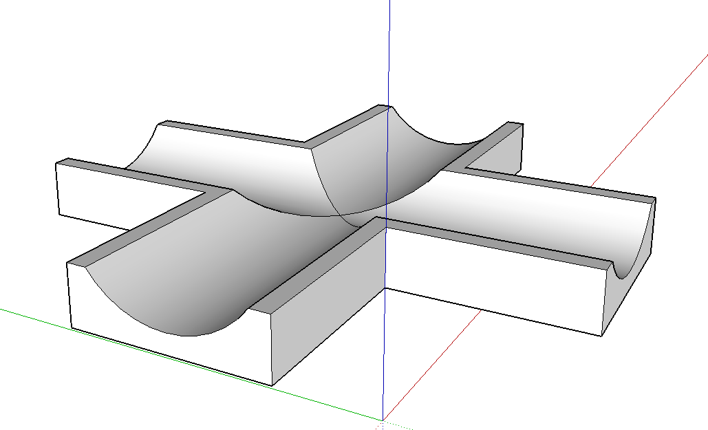

  • A crossing similar to this should minimize the need for the center rotation ...
  • mparkmpark Posts: 1,318
    I did use that sort of crossing in my first version, but I wasn't super happy with its performance. Maybe my 3-D printing skills were lacking. I might try again. I've recently been experimenting with just a flat crossing and it seems to work about as well as the cross, but still not as well as the rotating one.
