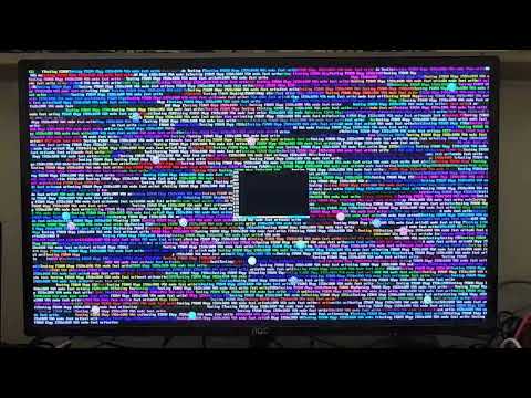

    I ported the driver to VGA - 1920x1080x50x8bpp. 16-bit PSRAM required. The picture is in reality sharp and good, YouTube destroyed the quality,

    Nice. You'll find with VGA instead of HDMI you'll be able to get higher horizontal resolutions out of the P2 with PSRAM. You can still use an external VGA->HDMI adapter too if required and they are cheap and seem to work rather well IMO.
    So how many request list items or separate window source changes can do you per scanline with 1080p50 and at what P2 speed are you running this? I'm guessing with reduced blanking you could run at around ~334 MHz or so at 50Hz refresh, still making 3 P2 clocks/pixel. If that's true you'd have 1920x3 = 5760 clocks per active portion which was previously enough for 15 source changes, or effectively 7 windows on a background, right? That took 4300-4600 clocks before so you should still have a small amount remaining for write bandwidth. That's the tradeoff you have there.
    EDIT: Actually above I neglected to include the fact that you would need to read 1920 pixels vs 1024 before, so I guess there are another 896 clocks required, so maybe the number of active windows would have to reduce slightly to compensate for that if you want some write bandwidth remaining...

    This is still 336 MHz as the frequency is important for the player. My monitor doesn't like reduced blanking and I had to use CVT timings with pixel clock 141.5 MHz - setxfrq ##$35C07228. The pixel clock itself is high, but there is a lot of time in hblanks:
    '                      bf.hs, hs,  bf.vis  visible, up p., vsync, down p.,  cpl, total lines, clock,       hubset                                scanlines   streamer    reserved reserved reserved
    timings         long   112 ,  200, 312,    1920,    26,    5,     3,        240, 1080,        336956522,   %1_101101__11_0000_0110__1111_1011,   1080,        $35C07228,  192,    0,       0            '1920x1080x50 CVT timings
    It seems this version can do the same list as 960x540 @ 4bit. The problem I have now with the list and windows is the memory for the lists. It is huge (at full HD it is near 300 KB) so I need to place it also in PSRAM.
