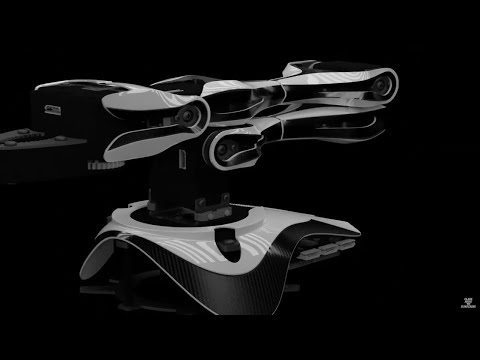

Beauty is only skin deep, but Lynxmotion's 6th-gen arm looks pretty sexy IMO! External black/white shells really jazz it up, even if the carbon fiber pattern is likely just for show. Too bad the sizzle video (bottom) doesn't show it in motion. http://www.lynxmotion.com/c-194-lss-arms.aspx
  • Skin deep is right. They don't show it moving because then it becomes Ricketymotion :lol:

  • Many years ago, I purchased a Lynxmotion SmartArm. It used Dynamixel servos. I think my version has a single servo for the claw but otherwise it looks a lot like the one in the photo below.
    The Dynamixel servos use a communication protocol which required a microcontroller to be present between the user inputs and the servos. The servos in this new arm use the Lynxmotion Smart Servo (LSS) serial protocol. The LSS protocol is "human readable" in that it uses only the printable ASCII characters but comes at the cost of slower data exchanges. The LSS protocol also doesn't use CRC or a checksum. I personally think the Dynamixel protocol is a better than the LSS protocol in this sort of application.
    I'd think it shouldn't be too hard to 3D print similar panels for other robot arms. I'm tempted to dig my SmartArm out and see if I can make it look better by adding some panels.

    With all respect...still rickety Smile.
    The P2 deserves some serious exposure. It represents a huge commitment on the part of Parallax. Who's gonna take it seriously when all we show is herky jerky Smile?
