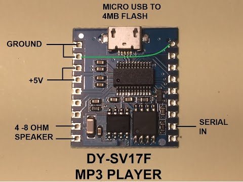

Multiple modes are available but I'm primarily interested in UART control, where only 3 lines are needed to control the player with your micro: +5V, ground and serial data. 4MB is sufficient for many projects. For reference that's the size of a typical 3-minute song. You can have as many smaller files as you like, using the usual names, 0001xxx.mp3, 0002xxx.mp3 etc.
The module has 5 EQualizer settings for normal, pop, rock, jazz and classic! I can't confirm the 5-watt rating of the amplifier, but it's PLENTY loud on my tiny 8-ohm pillow speaker. BTW the 5W spec is for a 4-ohm speaker. As my video shows, I put two series LEDs in parallel with the speaker and they flicker with the sound.

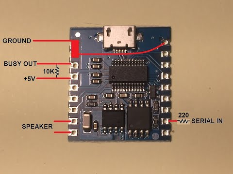

2) Pin 12 is a dual-use pin, initially used to set the mode, then to provide a BUSY output signal. I tried it and it does give a busy-low output but it generated motorboat noise in the audio output. The audio is clean only if pin 12 is tied directly to +5V. So for now, no busy output, your program has to know how long each file is and act accordingly. Edit: solved, see 4 posts down.
3) My BS2 Homework Board was resetting on max volume (power spikes) until I put a 1000 uF filter cap across the connector on top of the breadboard between Vdd and Vss.

    Update: BUSY pin 12 works fine using a 10K pullup resistor to +5V in conjunction with a 220 ohm resistor on the serial line. These are integrated into the BS2 Homework board.
    Good to know 😊
  • erco,
    Were you the one who annotated that picture?
    @Genetix said:
    erco,
    Yes, there is very little info on this module. I started at https://electropeak.com/learn/interfacing-dy-sv17f-audio-mp3-player-module-with-arduino/ where the guy showed connecting BUSY to 5V, which I know now is wrong.

  • I got mine today, and after parsing the docs, came to realize that the module has several different modes that are configured via the CON (configure) pins. Here's the table:
    To configure and hook up for UART mode:
    CON 1 and CON 2 connect to GND on the module, and CON 3 connects to 5V (via 10K resistor), as erco notes above.
    To make it easy and stand-alone, I just soldered a small 10K to the bottom between the 5V and CON 3 pins, and ran a wire from GND across to CON 1 and CON 2, like above. Then connect the speaker to those pins and run erco's code.
    The edges of the board are castellated, so it's obviously intended to be installed as a module - could be useful!
