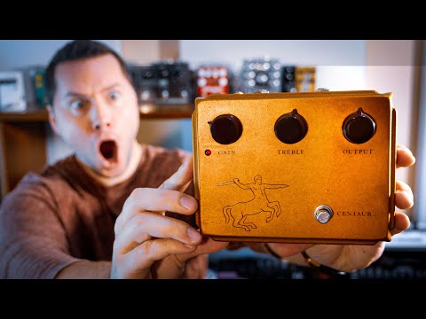

  • MicksterMickster Posts: 2,911
    edited 2021-08-02 00:20
    With the utmost respect; this is a lame idea :#
    These FX have been done-to-death and the "best" distortion pedal on the market has like $10 of passive components, is now open source, copied/improved by the Chinese ($30) but the purist idiots still pay thousands for a used original. It's called the Klon Centaur. Tell these morons that you have a P2 inside and they will instantly switch from "dude, that totally rocks" to "ah, yeah, sounds digital" :lol:
    A fool and his money are easily parted.
    What's really required?
    We already covered this:
    https://forums.parallax.com/discussion/171041/guitar-string-processor#latest
