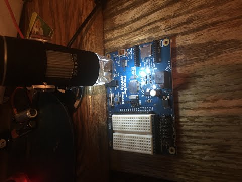

    I've been playing with, and have been impressed with a little USB microscope the wife got for the kids. Plugged it into my PC and self-installed and opened the camera app. Only 2MP resolution but IMO impressively clear images! 50X-1000X, comes with a tiny stand/clamp, worth building a bigger one for more gooder adventures. Quick tour of a Prop AB below. Cam is fixed in video below, pardon my shakey hand work moving the board around. Focus/zoom/lighting is all adjustable; I think this is quite useful for examining PCBs. I'm not sure where this one came from, but Walmart lists a similar-looking one for $15! https://www.walmart.com/ip/Digital-USB-Microscope-8-LED-Adjustable-Endoscope-Camera-Electronic-Stereo-Magnifier-1600X/926700248

    That little USB microscope I demoed above has a built-in rheostat to dim the LEDs, I found it to be very useful.
  • erco wrote: »
    I just ordered one. At that price it's certainly worth a try and your video looked quite good. I may get a pair of the glasses that Phil recommended as well. Even both together is far cheaper than the microscope I was looking at.
