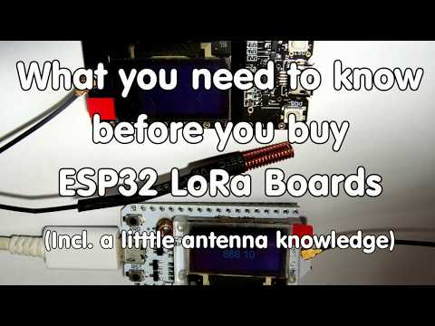

Have you looked at any of the many inexpensive LoRa devices?
Andreas Spiess has a bunch of videos on this topic. Here's one of his videos.
