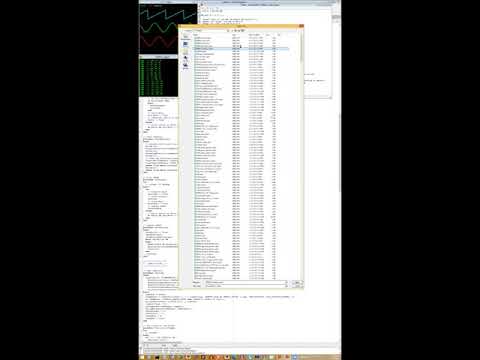

    In one of the webcasts, Chip mentioned a new Goertzel board which had much better resolution than the original board. Something to do with the copper geometry.
  • I assume the new boards are similar to the ones Chip uses at 19:19 in this video.
  • Similar yes. Those were the prototypes.
  • cgraceycgracey Posts: 14,287
    I have the new Goertzel board on my P2 Eval and it works great. It's working exactly as hoped for. It took an iteration to get it right. The new board has very linear response and no bias problem, as before.

  • Here is a 4x4 Touch Keypad for the P2 EVAL board. Each key goes to an individual pin on the P2 EVAL board - see attached pictures. The Keypad is made with a single sided PCB, using stylus milled isolation pads & traces. Something I can to fairly easily in my home shop - software: Sprint Layout, FlatCAM & Universal G-Code Sender. The table top CNC milling machine is a ShapeOKO
    Does anyone have any Goertzel software functions for a 4x4, 16 pin Keypad? Second, this PCB uses square touch pads, would it work better with round keypads? The PCB is painted Green to prevent the copper PCB Keypad from corroding and for electrical insulation & isolation. The keypad is a single-sided PCB, There is no backplane.
    Any suggestions are welcome. The isolation milled keypad is available FREE to forum members (PM me with your mailing address)
  • RaymanRayman Posts: 15,867
    @PropGuy2 I'm very interested to see how this kind of input works!
    PropGuy2, to measure activity on that pad array, the Goertzel circuit won't help, but I think you could just measure discharge time using a smart pin mode and 10uA low-drive with Schmitt-trigger input.
