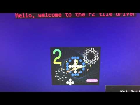

Was thinking about how to do 1080p video and it occurred to me that the P1 tile driver might be good for that.
Tested the idea out today, it seems to work (see screenshot).
Started out with 2 cogs, one for the video output and one to build the video line data.
If your P2 clock is below 250 MHz, another cog would be needed to help build the video line data.

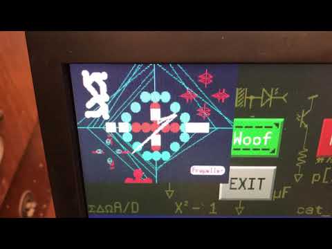

Update: New color scheme seems to work. Now able to replicate the P1 "VGA_demo" (see new screenshot below).
Driver is using the actual P1 ROM font do draw the characters and buttons.
Update2: Added "Graphics" from P1 and can run "Graphics_Demo"
Update3: Code now attached here.

    Driver can now perfectly replicate the original "VGA_Demo" for P1 in a small corner of the 1080p screen.
    So far, looks like this approach will work out nicely...
    If you want to try it, just run the attached binary with A/V board connected to P0 header on eval board.
    BTW: It's interesting that it looks steady with P2 clock set to 250 MHz and fpix = 148_500_000.0
    I thought I would need P2 clock set to fpix*2 to get a steady image...

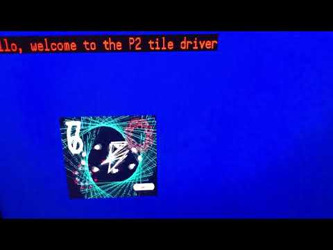

    I've almost go the famous "Graphics_Demo" ported over to here..
    It's recognizable, but still needs work:

  • RaymanRayman Posts: 15,795
    edited 2020-02-01 00:07
    It works!
    Here it is with no added delay in the loop.
    Much faster than P1:
    BTW: 1080p seems to work perfectly on any recent monitor, assuming it has VGA input.
    A lot of the ones I have (like in this video) are old though with 4:3 layout and 1080p doesn't really work... It cuts off the part of the screen outside the 4:3 format.
    Some others work better, but skip some of the 1920 vertical lines. This one does this too...

    And now, it's clear that there is an issue with 250 MHz clock.
    Although the image is stable, I can see that vertical lines appear missing, it's probably doubling some vertical lines and missing others.
    At 297 MHz, it looks perfect.
    That's expected, I think ? - as you will have sampling issues at non-standard clock multiples, so something has to give.
    For someone using larger fonts, this may be tolerable.
    Rayman wrote: »
    That's true, but it's not just the adapter, my old monitor was doing the same thing.
    I'll test some more, but I think we'll just have to run at 297 or 297/2....
    I wonder how safe it is to run at 297... I guess it's fine at room temperature.
    Overclocking to 297MHz is likely to be optimistic for volume production, as we still do not have a handle on how much wafer lots will vary with P2.
    The next chips will give a second sample, so may have some indication.

    I dug up some old code where I digitized the NTSC TV colors so can reproduce colors of Graphics_Demo better:
    See here where it looks pretty close to original:
    I added a delay to slow it down to somewhere close to the original.
    This monitor is interesting... It's old and doesn't know 1080p. I think all newer monitors will recognize 1080p...
    It only has 1680 horizontal pixels and yet looks good with 1920x1080 with P2 clock at 297 MHz.
    BTW: I have to thank rogloh for showing me how to do 297 MHz. I didn't realize you could set xdiv to 20 and then xmul to 297...
