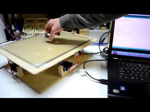

Hi,
since some long time I am wondering, if something like this:
https://www.amazon.com/Micord-Original-Wooden-Labyrinth-Solitaire/dp/B01M25QHJG
could be controlled by a microcontroller, perhaps P1?
The motion shall be done by two servos motors.
But what is the most easy way to detect the position of the ball?
The ball shall have a diameter of 6...12mm and could be made of wood, glas, steel....
The board shall be made of plywood, bores have to be applied.
The position must be known with perhaps 5Hz and perhaps 1mm/150mm accuracy in two directions on the plane. Calibration regarding linearity would be possible.
So I would be grateful for ideas, how to measure this!
Thanks in advance!
Christof
  • Use a camera looking down from overhead. If the ball is a contrasting color extracting its position will be fairly fast and simple. Anything else is going to be much less accurate and more expensive.
  • I agree with localroger.
    The video below may offer some ideas on tilting the board with servos.
  • You might just connect the servo horns to the handles and use the camera idea.
  • Thanks!
    Yes a camera seems to be a possibility!

  • I thought of the touchscreen idea but rejected it because it will stop working if you drill the fall-through holes in it.
    You could also theoretically put the table on three load cells and interpolate the weight change, but I think the operation of the tilt table would create too much noise. I have some feel for this since I work on weighing equipment in my IRL job.
  • Perhaps a stepper motor driven two axis gimbal with the top attached to the inner for x(or y) and inner mounted inn outer ring for y(or x) tilt capability. For position, if the ball is has a taller profile than the walls, maybe an Led or photo luminescent strip opposite a linear array of photo diodes or mirror/lens/single line ccd chip camera as used in copiers to figure out an X/Y position for the ball.

    Car Backing cameras are under $10 and output NTSC, so one of those would be worth experimenting with.
    As there are known strip-paths for the ball, you can make the ADC somewhat slow (~ 10 samples per line, but they can be sysclk-strip aligned) and one issue could be getting contrast between Ball and holes.
    Or, that could be a software problem where the holes are fixed/known, and masked out, and hole/no-hole info could even be used for threshold setting & lighting control.

  • Take a look at the openMV camera. I've used it with the propeller before, and it works really well just sending serial data like a coordinate.
    openmv.io
    I think they are around $65 or $70. Probably the cheapest way to do what you are trying to accomplish.
  • Christof Eb.Christof Eb. Posts: 1,420
    edited 2019-08-23 05:46
    Thanks for the inputs!
    OK, I will focus on cameras. I have read, that Ov7670 can output a subwindow. Perhaps this would make it possible to use a less powerful processor (no big RAM) and to have enough resultion and speed at the same time.
    Christof
