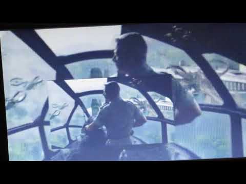

  • I've now added audio playback and can play this as a separate file simultaneously with watching the video. In TAQOZ when files are opened it uses the starting sector as a handle so that in the case of the video the frame number is actually a sector address and so too with the audio. Since reading a QVGA frame takes about 23ms or so I had to increase the audio buffer size to 4K so it only needs to replenish a buffer every 45ms or so. The video has some resizing artifacts in it but I've left it like that to concentrate on making it work first, and then optimizing it later.

  • While I was creating an audio waveform display which I haven't finished yet since it needs some nice rounded lines to join the dots yet, I nonetheless indulged in playing a bit more and added a simple one line effect that modulates the picture to the music. See what you think.
    pub MODULATE  POLL: ao W@ 16<< 22 SAR 120 + vint C! ;
