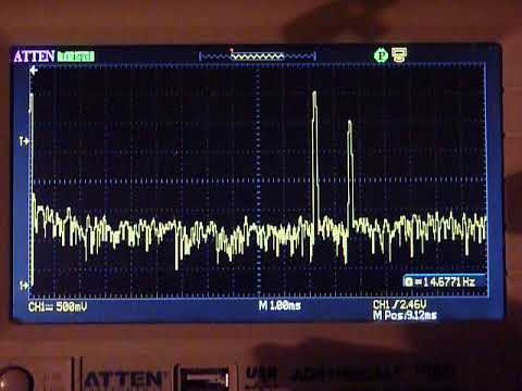

  • Couple of videos
  • Figured out I was being a bit dim with the FFT inner loop and its down to one cordic rotate setup the previous loop,
    about twice as fast now, 210kSPS at 2048 points, 170kSPS at 16384 points, 150dB or so of dynamic range with
    fix5.27 internal representation.

    I'm adding the feature to do real input FFT packed into half-size complex array which
    should (once I have it working) give a nearly 2x speedup, although complicates the various
    options - hope to have some testsuite code for most of the features and release it as an
    object within a week or so.

  • Update, after two pretty unproductive evenings of bug-hunting finally got real FFT (packed into halfsize complex FFT)
    working, meaning a speed up to 325kSPS from 210kSPS.
    (So now 6.3ms per 2048-point FFT with a single cog - haven't thought about parallization yet)
    Not quite the doubling in speed I'd hoped, but I did shake out a few bugs that only affected the phase of the
    FFT result which were just breaking the real FFT completely in baffling manner.
    Next stage code and options rationalization/tidy up...

    Right, time to post some code, I've done some speedups by using block reads and writes wherever possible and
    unrolling some loop bodies substantially - using LUTram now for more codespace. as a consequence.
    There's a tiny testsuite in spin, and hopefully enough documentation at the head of the file to explain
    how to play with it. Not all the modes are tested, but real and complex inputs with stride 8 have tests.
    Current raw FFT speed for real input on 160MHz P2 with 2048 point FFTs is about 745kSPS, and for
    complex input, 475kSPS. With real input and output squared-magnitude mode the speed is 655kSPS.
    As a for-instance, reading 2048 sample blocks at 48kSPS from analog smartpin, which takes 42.6ms to
    acquire, each block can be processed in 3.1ms, about 13 times real-time, leaving lots of slack for overlap/add
    style processing (although there would have to be some more copying overhead in this scenario).
    [ Its interesting to spot the various uses of new P2 instructions like incmod, subr, decod, although I'm sure
    there's a few I've not used but would be ideal, there are so many new instructions ]
    [ And I've just noticed I've achieved 6 times the initial performance figures, looking back at my first post ]
