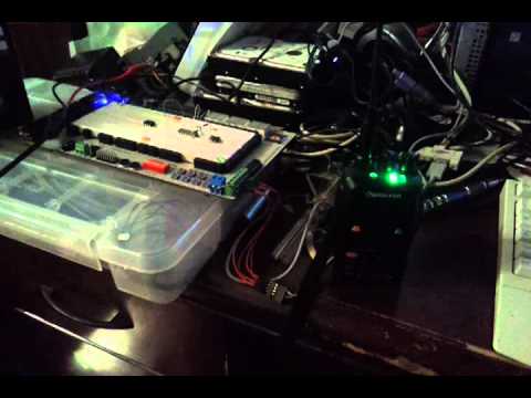

    I made the P1 broadcast audio on the 2M FM band.
    That said, this is not the right way to do it. The square wave output has a ton of harmonics that pepper the spectrum with noise. You will note in the article that there are very significant off-frequency peaks in their spectrum sample.
    It could be possible to use the DACs to generate a 27Mhz sine wave, given that they can do 1080p component video, which is 60Mhz+
