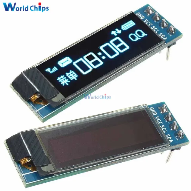

Is there any way to use an SSD1306 oled with the propeller in Propeller-GCC?
https://ae01.alicdn.com/kf/HTB1QRR_bUgQMeJjy0Fgq6A5dXXam/0-91-Inch-128x32-IIC-I2C-Blue-OLED-LCD-Display-DIY-Oled-Module-SSD1306-Driver-IC.jpg_640x640.jpg

This is in the OBEX:
http://obex.parallax.com/object/725
The Parallax Hackable Badge uses that chip:
https://www.parallax.com/product/20000
Yeah I found that before, but that is spin code. I want to program in C.
https://sites.google.com/site/propellergcc/documentation/tutorials/spin2cpp
Read around on that site, there's loads of good info there
https://learn.parallax.com/tutorials/language/blocklyprop/memsic-2125-tilt-oled-bubble-display
https://learn.parallax.com/tutorials/language/blocklyprop/rfid-scan-and-store-eeprom-project
https://learn.parallax.com/tutorials/language/blocklyprop/oled-display-blocklyprop
You can take the C code from these programs and run them in SimpleIDE.

Oops, got lost in this thread. The SSD1306 is also available in the latest Simple Libraries as part of the Badges. You can include one of them in your project and use the display or you can copy out just the display piece as a separate library.
