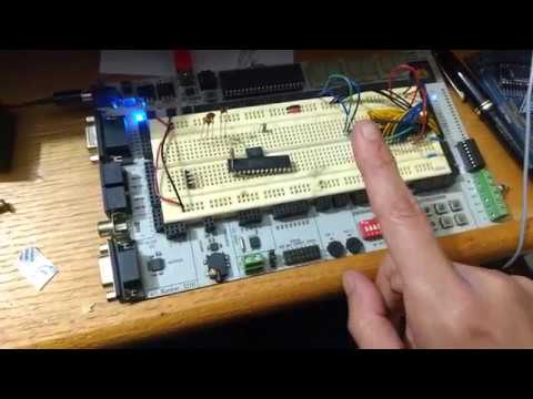

I was writing and testing some code for a project I have in Customer Projects, when I noticed that each time I placed my hand within 1.5 to 2 inches it would be detected by a hanging wire connected to a propeller pin. I have I2C code running on the pin next to it so I am curious if it is creating capacitance...

I have never noticed this with the Propeller before.
Can an anomaly like this be relied upon to work all the time?
Here is a video showing it:

  • JonnyMacJonnyMac Posts: 9,853
    edited 2018-05-29 13:20
    As you know, breadboards are like a bunch capacitors and can be problematic in development. I've used the MCP23017 in a few commercial apps with proper PCBs without any problems; one of them was a networked HVAC system that used the MCP23017 to provide chips select signals to a large array of sensors -- similar to what you're doing.
    I've attached my MCP23017 object in case you'd like to compare code.
  • JonnyMac wrote: »
    The I2C driver is based off your code, modified by Erlend Fj. Your included zip seems newer so I'll give it a try.
    That is a nice demonstration that our electronic circuits are not just a collections of components that do whatever they do connected by wires that do nothing except connect those components together electrically. The so called "lumped circuit model".
    No, our circuits are a big wobbly jelly of electric and magnetic fields that allow every part to interact with every other, including parts that we don't think of as being in the circuit, like your hand. In ways that are often difficult to fathom. Ping on one part of that jelly and all the other parts quiver.
    That is probably caused by the signal your body is picking up from the 50/60Hz AC lines all around you. A fairly common phenomenon when using prototyping boards and point to point wiring with chips that have very high input impedances.
