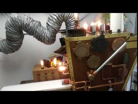

Here's a video of the wacky prop I helped on. I added the amplified MP3 sound and the 555 timer to toggle a relay that cycles a linear actuator to move that big silver hose back & forth.
