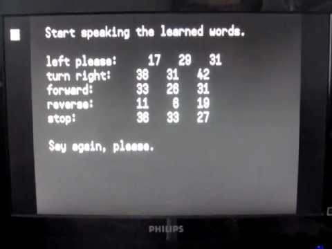

  • When Phil Pilgrim wrote that object that responds to spoken commands based on Goertzel's algorithm my jaw dropped. When we get the P2 the Goertzel circuit will be one of the first things I intend to learn about. Great job Chip!
  • I agree, this is just great.
    Now to dissect the code... think there's a lot of help going on with streamer and smart pin

    I posted Phil's object on YouTube. Here's the video.
