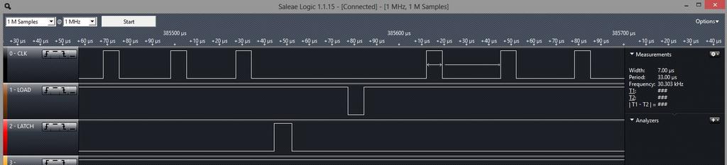

I am new to the Propeller and Spin.
I have question on a simple setup with 2 chained HC595 shift registers controlling 16 LEDs.
I am trying to duplicate the behavior of some Arduino code on the Propeller; the Arduino code works just fine on my hardware setup, but the Spin version does not. The Spin works ok for the lower order 8 bits but not for the upper 8 bits of the 16 bits going out.
When I put out $0002, the first 595 shows the second bit on, all others off. Good.
When I put out $0200, the first 595 shows all LEDs off, and the second 595 shows the first and second bits on, instead of just the first bit.
The code has a commented out test counter as well, which shows the problem.
My question is what is missing/wrong in my Spin code?
(note: some code derived from Chris Savage and I am sure it is not a problem from his code).
I have attached the Arduino code which works and the Spin code which does not.
Thanks for any help.

  • These are screenshots from my old website. I also included the timing diagram, schematic and SPIN code.
  • Thanks for the response. I saw your code on one of my Parallax/Google searches, and I think my code conforms to what your did. But I can't get the high order bits sent out to two chained 595s to show correctly. The lower 8 bits (first 595) show correctly but the second always has more bits going out parallel that the serial data sent in.
    I also tried the shift register code I found on OBEX ("Shift in out demo", 74HC595_Regular.spin) and could not get those to show the 8 MSB correctly.
    So I must be doing something wrong, and would suspect my hardware setup. But like I said it shows just fine with the simple Arduino code.

  • I don't have an HC595 to test but something caught my attention: It appears that your 'pause' is only a micro second plus the overhead of a method call.
    PRI Pause(ms)
      waitcnt(clkfreq / 1000 * ms + cnt) ' Convert To mS THIS ACTUALLY EQUALS A MICRO SECOND
    Please try this and see if it helps.

    The photo attached shows the result of an output of: dataOut16Bit($0100), LEDs 1,2 on the second shift register being on instead of just LED 1.
    An output of dataOut16Bit($0200) results in LEDs 3,4 being on. That may be a clue, but once again the exact same hardware/conneciton setup on the Arduino works correctly.

  • Thanks to everyone for the help.
    I swapped out the 595 chips and pulled the jumper wires on the breadboard and re-pushed them in. I did not find any thing that was wired up incorrectly, but it now works on the Propeller and oddly it still works as it did before on the Arduino. Perhaps a glitch in the breadboard? Don't know.
    It is a bit of an unsolved mystery, but I won't argue with it. It now works as it should.
