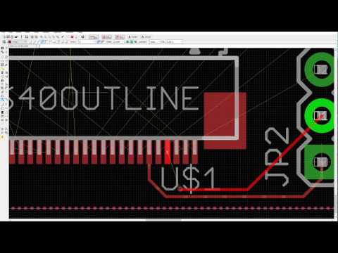

Does anyone have a link to a SIMPLE tutorial for using Eagle to design circuit boards? I've tried using the program to create a simple board using a 78XX regulator to get a circuit board for various power supplies.
I've laid out the components in a as they might be drawn on paper, but when I try to create a circuit board, the traces criss cross the window like a child's scribbling!

    Oh, by the way, that jumble of wires is what is called a "rat's nest".

  • Can you post an image of the crisscrossing. What you describe sounds like rats nest and an unrouted board. You can press autoroute to route the board but there are parameters to learn to do that.

    I think, just by what you are describing, you may just be seeing the un-routed "rats nest"/"air wires". YouTube has several really good videos by searching "eagle board layout tutorial"'s. What I think you are seeing is where the connections come and go to according to your schematic, aka "rats nest"/"air wires" which is what is will be called in documentation you are reading or may have read.
