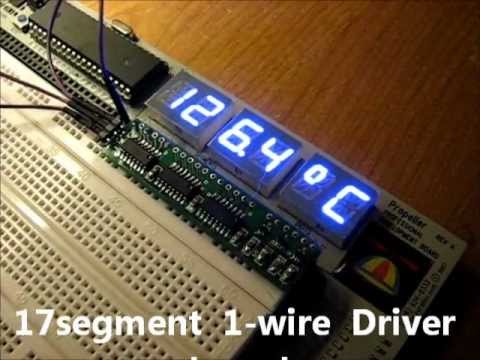

    1pin: can be done: The sink-mosfet gets its signal from the 595.
    4pins makes it easier, inserting dead-time between sink-mosfet will help with capacitance on the lines that could light up wrong LEDs for 1/100sec
    10pins and you can parallel them instead.
