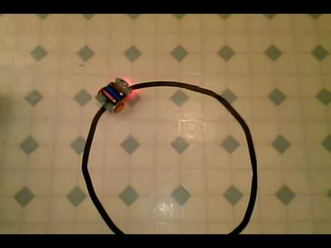

I successfully combined three of my recent passions into one tonight: cheap line follower robots, the magnificent 555 timer, and using copious amounts of alarmingly cheap Ebay China parts. I've been saying for ages that we're foolish for not using 4-cent 555 timers and multiple nickel photocells in every project. Well, that's nearly all I used here. I hacked one of the $5 Ebay line follower kits. Tossed the 393 comparator, two trimpots, two driver transistors, and four resistors. Now one 555 does it all: reads two photocell line sensors and drives two motors. Minimalism rules. Beau & PhiPi et al: any way to do it cheaper yet?
    BTW, I've wondered if a 555 could line follow ever since Parallax's amazing LFO course in 2012, so I can die happy now.

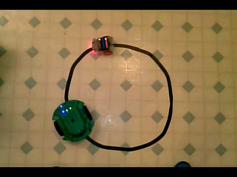

  • @erco, The cheaper you get, the better they run.
    Nice and smooth.

    Amazingly smooth for such a simple circuit. any idea what frequency the 555 is toggling at?
    Probably 200-400 Hz, depending on the lighting & photocells.

    Seriously though, I love the simplicity, but wasn't expecting it to be as smooth as it was.
    The S3 in your video sounds like a mad rooster.
    Ha, Yes, smooth. But no, can't turn too sharp, therefore the large radius. The photocells & LEDs are just hanging out in the breeze and the voltage differential isn't that great. Probably with some experimentation, isolation and aligning it could be improved.

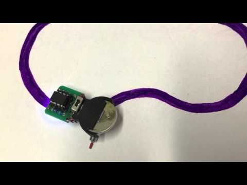

    Also uses two photocells. Cute.
    Drats. For rock-bottom minimalism, I still can't beat this one-motor, no electronics line follower. :(
