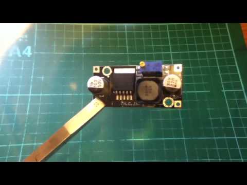

    Wouldn't one of these nice switch-mode regulator chips work as a motor PWM if you skip the choke etc and directly drive the motor and filter the feedback voltage?
    EDIT - actually, the speed control pot would be the "feedback" but otherwise it would just be an open-loop PWM driver.
    edited 2017-01-10 23:09
    Good call, first responder PeterJ! This video shows an LM2596, which may deliver 150khz pwm. I have some of those somewhere, might be worth trying. Thanks!
    edited 2017-01-10 23:15
    Yep, I'd skip all the traditional SMPS circuitry and use a SMPS chip as a bare open-loop PWM but you'd have to get that PWM frequency very low as the motors certainly won't like those high frequencies.
    The SMPS module is the easy route though if you are not worried about feeding a linear voltage to the motor. Direct motor PWM overcomes stiction and allows it to run smoother at lower speeds.
