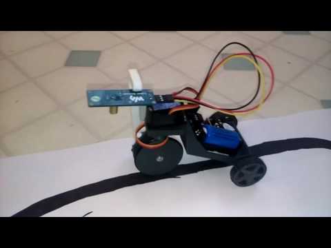

She works! My new 3D printed tricycle bot uses the Waveshare laser sensor ("obstacle detector") to follow the edge of a line. I had to remove the lens from the sensor, as Parallax (!) error prevented the sensor from working at close range. Without the lens, the sensor is finnicky and range-limited.
This is also my first use of the new Feetech digital CR servo. Pretty good, just the slightest bit of binding in one spot.
