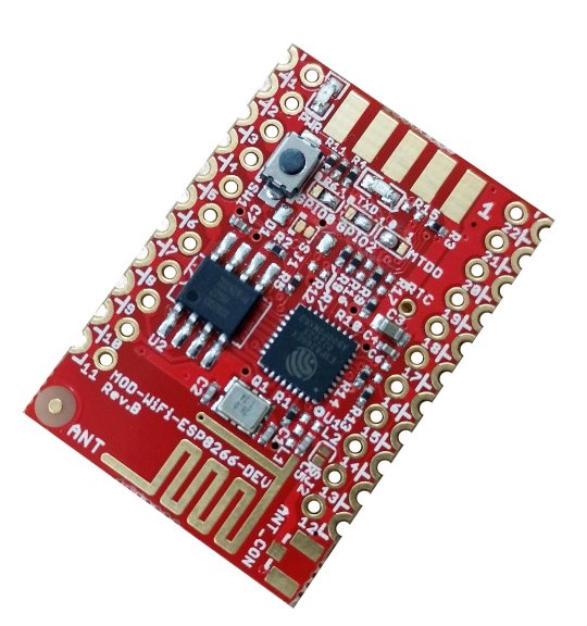

I encounter a major bug where i think the SPIFFS filesystem isn't properly created, or something.
When I look at the debug port(DBG, GPIO2) I am getting garbage. And The esp doesn't do any AP transmission.
I did mention before that the second part of the flashing procedure doesn't work.
"make htmlflash"
When i flash another program that contains a SPIFFS file system (using the arduino SPIFFS file system uploader, and then if I reflash my chip with the parallax-esp program,
The parallaxesp program works fine. AND SO DOES THE DBG(GPIO2) output at 115200.
To test this, I went through this procedure many times with multiple different esp devices.
You can test it by issuing the command: esptool.py --port /dev/ttyUSB0 --baud 115200 erase_flash
Then try to reflash with parallaxESP, if you monitor GPIO2 at 115200 baud, it should then throw out garbage.
Can anyone confirm this problem?
Or is it possible that my make htmlflash not working is the problem?
Another possible bug, is the renaming feature of the module, it does not save to flash, and doesn't show up as the new name in the ap list or its network hostname.

Garbage issue still happening, im looking into it more... by trying different things.
So I ran these:

Now the debug port (dbg gpio2) shows proper info, and the esp's AP shows in the wireless devices.
So I had to run clear.sh and clear-ffs.sh
This was after desoldering a 2MB flash chip on my ESP to a 16MB flash chip.
I am guessing the new-unused 16MB flash chip contained some seriously random garbage, that caused issues.
The ESP now preserves my MODULENAME that I changed it to, AND the MODULENAME I changed it to shows up as the AP broadcast name. (when I search for wireless networks, it shows there)
I noticed that when connected to an AP, the original module name shows up as its hostname still. (which is part of its mac)
Also the DBG (gpio2) port is much more verbose than before.
Dang, i should have used the sh script to begin with.
Perhaps all this trial and error im going through will help create a newbie help file, hehehe...

It doesn't make sense that you had to run clear.sh and clear-ffs.sh before running flash-all.sh. The flash-all.sh script does the same thing as both of those combined plus it flashes the bootloader and the firmware. Just that should have been enough. Also, there really shouldn't be a problem with random junk in the flash chip. The esptool always erases a sector before trying to write it. I wish we could figure out what was causing this problem so I could fix it.
I am able to recreate the junk problem by doing this.
:~/Parallax-ESP$ esptool.py --port /dev/ttyUSB0 --baud 115200 erase_flash
esptool.py v1.2
Connecting...
Running Cesanta flasher stub...
Erasing flash (this may take a while)...
Erase took 48.1 seconds
AT this point, when I power cycle the esp, i get junk out of DBG, and the unit will not produce an AP.

Yea, im saying i want to change the firmware settings so when i run flash-all.sh, my esp is already programmed with its ssid and password.
I have 8 of these, and they seem to be a bad design.
I seem to have nothing but problems with this particular version:
But this one below works great with your software. (i have two of these, and both work perfectly)
https://www.olimex.com/Products/IoT/MOD-WIFI-ESP8266-DEV/open-source-hardware
http://www.digikey.com/product-detail/en/olimex-ltd/MOD-WIFI-ESP8266-DEV/1188-1154-ND/5247121
The original modules typically need such action, more complex devboards don't...
