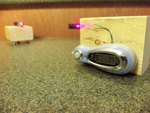

I'm designing something like this..
The problem is I don't have a IR Phototransistor. Where do I look for one?
This is the only one I have
http://osepp.com/products/sensors-arduino-compatible/ir-receiver/
Does it work the same way? If not, why and what's the difference?
I just finished shining a laser through it nothing's picking up.
    edited 2016-09-22 02:22
    If you're using a visible-light laser a sensor optimized for IR will not be able to detect it. But more importantly, the detector you cite requires that the IR be modulated at 38kHz to be detected. So just shining a constant laser beam of any wavelength will not be detected.
    What is the wavelength of your laser? Can you modulate its output?

  • You could try any phototransistor that's sensitive to 650 nm (red), or you could try a light-to-voltage or light-to-frequency converter, like this one:
    https://www.parallax.com/product/604-00084
    A deep red filter in front of it will help to reduce the effects of ambient light.

  • To answer your first question, if the part number is stamped on it, you go online and get the datasheet, which will give you its spectral sensitivity range. Otherwise, just wire it up and try it.
    As to the second, what do you mean by "enhance the wavelength"?
    I've been trying find to uses for my old-school dime-a-dozen CdS photocells. I know they are most sensitive to yellow green, but I see them used with red LEDs and red lasers all the time.
    OK, maybe not a dime a dozen, but still dirt cheap a dime each: http://www.ebay.com/itm/10PCS-GL5506-Photoresistor-LDR-5mm-Light-Dependent-Resistor-Sensor-for-Arduino-/381479722923
    http://www.instructables.com/id/Another-Arduino-Laser-Tripwire/ (Granted, that guy is using an Arduino, so his logic is questionable, but apparently it works.) The photocell resistance will be lower when it is illuminated by the laser or any other light, and vice-versa. With some good old-fashioned experimenting, you could make a passable sensor with just a photocell and a fixed resistor forming a voltage divider. Tweak the resistor value so that the beam broken/not broken voltage output are higher and lower than the BS2's TTL threshold of ~1.4V and you can read the pin as high or low. Easy peezy, low tech has its place!

    Photocells and phototransistors operate in completely different ways. Typically a photocell will have a slower response time to a sudden change. I prefer phototransistors for anything designed to interrupt light. I only use photocells in light detection.
