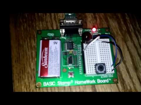

This BASIC Stamp 2 flashes & beeps in the Haiku pattern of 5-7-5. Better yet, all BASIC code and comments to flash the pattern conform to Haiku rules of 5, 7 and 5 syllables. LED & beeper wired active low on pin 11.
' BS2 Haiku
' Code & comment syllables
' Must form a Haiku
' Also BASIC code
' Must make a Haiku pattern
' flash 5-7-5
Q VAR Byte:PAUSE 1
C VAR Byte:B CON 15
T CON 100
main: HIGH 11
C=B-5
GOSUB flash:PAUSE 1
PAUSE 700
C=B-1
GOSUB flash:PAUSE 1
PAUSE 700
C=B-5
GOSUB flash:PAUSE 1
PAUSE 750
PAUSE 20:PAUSE 1000
PAUSE 10:GOTO main
flash:PAUSE 11
FOR Q=1 TO C
TOGGLE 11
PAUSE T:PAUSE T:NEXT
PAUSE 1300:PAUSE T
PAUSE 7:RETURN
